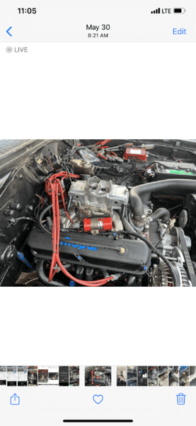

So I’ve recently rebuilt my 360 haven’t really gotten to break it in yet due to the overheating issues I’m currently facing I even took the thermostat out so the I wouldn’t have to worry about that and still I’m overheating not really sure why thought it could be cause the radiator wasn’t bled but that wasn’t the issue the water pump is basically brand new and so is the coolant in the radiator I don’t have any leaks any help on how I could diagnose this or what I should change would very much appreciated I’ll post pictures later
I would check the impeller on the water pump make sure it’s not fallen off , or loose , timing too , flush the rad or replace if it doesn’t flow well does it have a shroud ? Let us know what you find ?

You haven't mentioned the fan? Is it shrouded? Generally when breaking in an engine there is a heat Spike but it drops back down generally pretty quickly. I've kept a water hose handy and just ran it over the top of the radiator cool it down during the heat Spike and generally the temperature comes back down. Also verifying your temperature gauge is working properly with an external heat gun. It could be a bad radiator cap all kinds of stuff...
the picture is worth a thousand words if you give a shot of your setup and your fan and things like that it may help..

looks good and I think I see at least one electric fan there if you have a picture of that set up a little closer that would be interesting to see as well. also having an external fan blowing like a box fan a cheap one from Walmart blowing in creating error. And as mentioned the timing? I know it's hard to shut right out of the gate but once you get it running you can kind of twist it and get the timing right. Also like mentioned stuff you can't see like a broken impeller or something...

I Have fans connected and on the whole time the car is on the fans is shrouded and I have a brand new radiator cap
