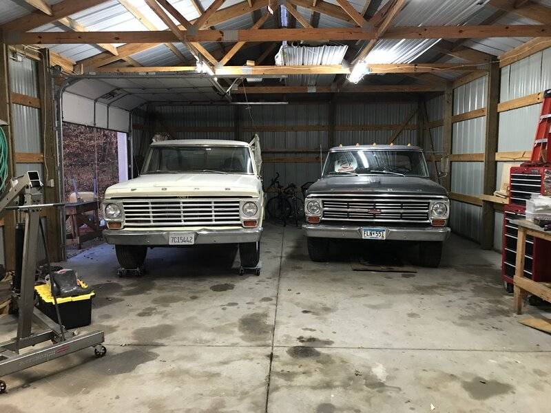

I've always only had a garage, and never a Shop, per se, and this metal building was one of several reasons we bought the new place a couple years ago. Here's a picture from when we were moving-in:
Building measures 24' x 42' with a 10' ceiling, has 100 amp service, and the wall posts are 7' on-center. I'm planning on building the walls "sideways" (7' tall w/either 18" or 24" centers, laid-down sideways) so that I can utilize readily available R-25 insulation), and I already have a furnace and A/C for it. Floor is already in, and because I don't know the thickness, and don't want to drill (plus I don't have much height to work with), a lift of any sort is out of the question, sad to say.
I have all winter to think about what I'd like to do with this space, and I do have some ideas (such as adding windows, and getting rid of that back OH door), but I'm also smart enough to know what I don't know, so I'm looking for advice from those who have "Been There & Done That". What should I be thinking about, and what mistakes should I avoid?

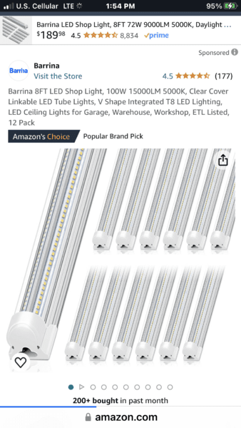

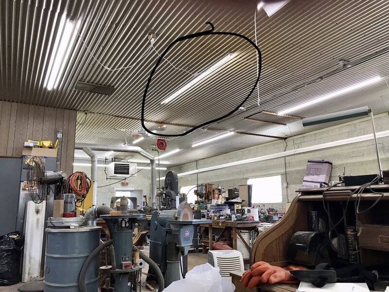

I got these from Amazon and have had really good luck with them. Way cheaper than florescent and I only had 1/2 of one go bad in 5 years. I replaced 50 florescent fixtures which I tossed out cause no one wants them. Big improvement, brighter and cheaper than buying bulbs and ballasts.
I will definitely look into these.
Thanks!

I have 17 hung in my dad’s 2800 sq ft shop. Even though it’s daylight outside, they still throw alot of light. The one circled is the one that 1/2 half went dead after 5 years. Big deal, at $19 a pop, compare that to the cost of a cold weather 8ft florescent light and they are instant bright. You dont have to wait for them to warm up.

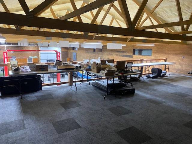

A second floor of about half will be added in. This will provide a mega work bench and some machines as well as a welding table. Second floor for many spare parts and a couch, fridge TV, etc

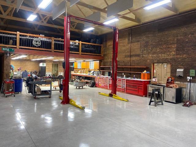

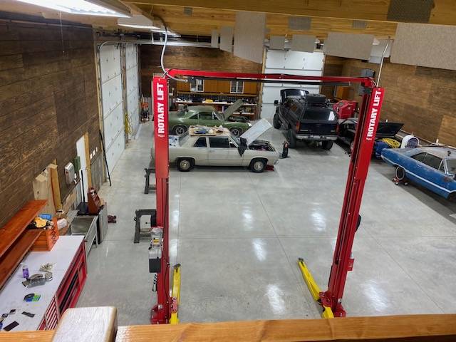

Installed ballistix floor coating on floor my air compressor is under stairs. The air line wraps entire shop complete 360 for maximum air pressure with several drops throughout. I went with brighter lights under mezzanine as easier to see for engine work or tedious work. And will complete a separate paint booth next year just to do everything myself (hopefully). Stainless sink area needs finished and full bathroom need completed as well.
Installed ballistix floor coating on floor my air compressor is under stairs. The air line wraps entire shop complete 360 for maximum air pressure with several drops throughout. I went with brighter lights under mezzanine as easier to see for engine work or tedious work. And will complete a separate paint booth next year just to do everything myself (hopefully). Stainless sink area needs finished and full bathroom need completed as well.View attachment 1716310545View attachment 1716310546View attachment 1716310547
Dammm!!
Very, very cool!
Mopar Nirvana!
