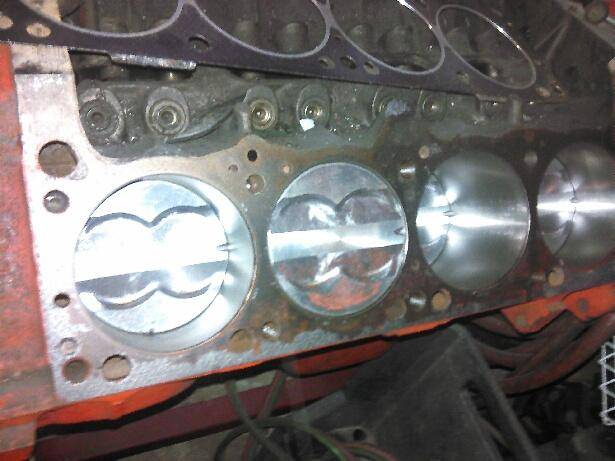

Trying to ID those pistons.. got a PN?
Ditto! Not to be a jerk but I do not think your at a 11-1 ratio with those slugs. I run KB-107’s, a flattop with 5cc valve reliefs at zero deck, .039 head gasket (I forget the diameter) with an Edelbrock 63cc head and technically I’m not at 11-1. Close, but no actual cigar.
You have the same size, double mirror reliefs in those slugs. I see a much lower compression ratio. Sorry. I’m not trying to be a dick about this. But that is what I see.

Those pistons look like my sealed power hyp. 405cp. Mine are down .050 in the hole and have 10cc valve releifs. If so you at about 9 to 1 comp with a .039 gasket.
And how big of combustion chamber?
