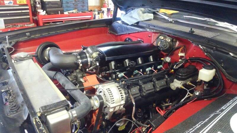

1970 Duster 340, 2012 5.7 hemi from a truck. Stock except summit cam mds delete, locked vvt actuator. TTI headers, holly sniper intake with a Fast 92mm throttle body. 4spd manual and 3.91 suregrip. Ran 13.13 at 107.9 mph with a 2.00 60ft. Still working on the tune and the launch still more than a full second slower than than the stroked 340 I took out. Hopefully to get down to the mid 12s this season.
