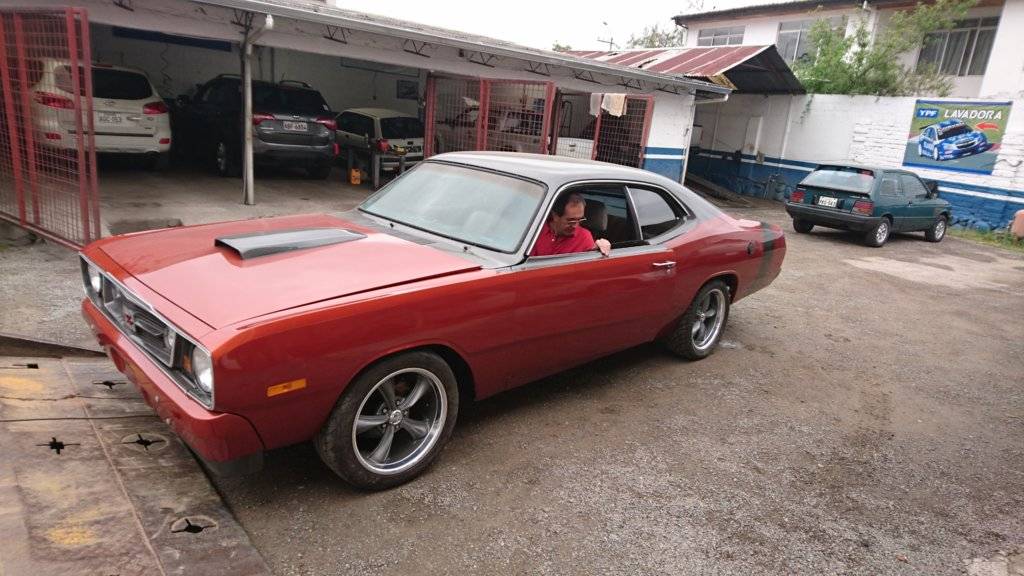

I setup my 75 Dart Sport Coupe Resto Mod with 17 x 8 Wheels all around.
Front Tires are 235 / 45 / 17's and Rear Tires are 255 / 40 / 17's.
Great Fit all around and I like the Stance.
Hope this Helps.
