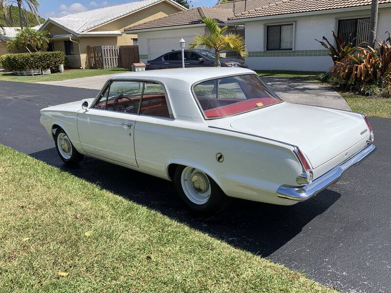

Not as nice as a lot your cars, but here's my '66 Valiant. I bought a set of 14x4.5" steelies and some Toyo 185/75s to put on them. The tires showed up and I realized they were gonna be way too tall for the fronts. Decided to keep the 13s up front and put a new pair of Uniroyal 155/80s on those. Scored a nice set of dog dish from a fellow boardmember to class things up a bit. Pretty happy with the stance, but I think want to drop the whole car an inch or so.

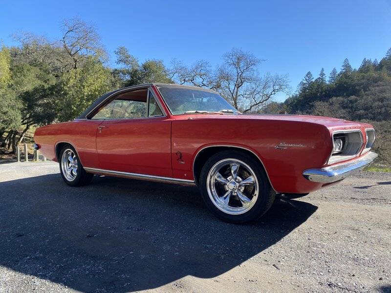

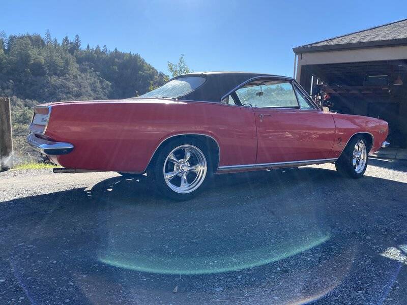

1967 Barracuda notch back
Front
Wheel Brand-American Racing Torque Thrust 2 515
Size-17
Backspacing-5.48”
tire size 245/45/17
Suspension mods- disc break upgrade, rebuilt LCA, bilstine shocks
Rear
Size-17”
Backspacing-4.81
tire size-245/45/17
Suspension mods-8.25 rear ended swapped somewhere along the way.
Thanks to all who helped me figure out what sizes would work.

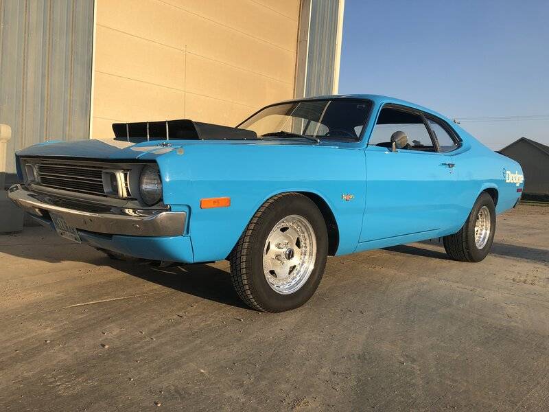

Front-
Centerline Convo Pros
15x4” I believe unsure of the BS
165/80/15
Rear-
15x8 w/ 5” BS
275/60/15 Nitto DR
Suspension mods-
Comp engineering shocks all around
Stock front end components
002/003 SS springs
Springs relocated
Mini tub
Stock Abody width 8 3/4
How's the turning ability with the 15's (do you have manual or power, stock or tight ratio)? Do they hit the front fender on hard turns (i've heard from some that can happen)?.. Thanks!
Turning is fine, no interference. Stock ratio power steering. Could probably space it out another 1/2”-1” without issue. Front is currently sitting about 3/4” off the bump stops

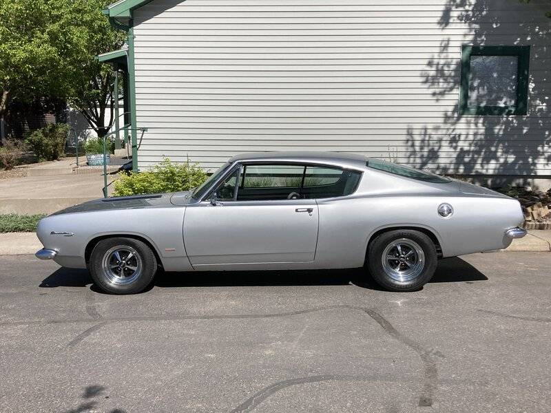

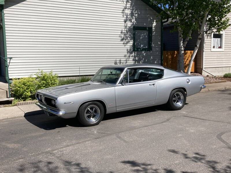

67 Fastback
Front:
Cragar Magnum 510
14 x 6, 3.5” back space
BFG Radial TA P205-70-14
Rear:
Cragar Magnum 510
15 x 8, 4.5” back space
BGF Radial TA P245-60-15
