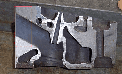

In order to fit the exhaust into the standard engine compartment Ford make the exhaust turn about 130 degrees in the exhaust port...
The serious racers would slice the outer 3/4" of the head off & furnace blaze on side plates allowing the port to continue upward... Not easy to find anything on the internet cause there have been aftermarket heads almost as long as theres been an internet.... But I found a few pictures so y'all can get an idea of what was involved...
