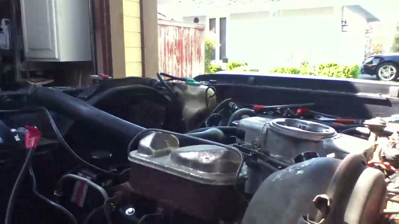

I finally have a meaningful update: It's alive(sort of)
I fixed the leak i had which turned out to be my own fault, I didnt remove the hose fitting when i had to tighten the fitting on the pump a little more. Which from what i can tell, spun the barb in the hose and ruined the seal. So i just cut the hose, replace it with a new push lock fitting(just for good measure) and no more leaks. :blob:
I wired everything up and went to load a tune, but i hit a hiccup with my netbook/tuning software/drivers. So i figured i was sunk for at least the day. But for the hell of it i thought: "I wonder if it would start with the old tune", which is a tune for a Blown ford 460 w/ 85lb injectors. Obviously running very very very very rich, but it came to life(click on picture for video):

I think i have the netbook issues sorted now and i'm gonna go try it out in an hour or so.

Cool! Glad you got it fired off.
