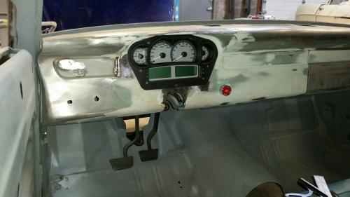

So Still waiting on parts I need to keep moving to do what I can until I can get the drive train in. So I have been on the hunt for some heat extractors that fit the build and something that will look right on the hood. Need to get that heat from the turbo out from under the hood.
Well I found something that I think will work They fit the body lines of the hood These will work just fine. Now I need to cut the hood and build some trays to mount the heat extractors flush with the hood. I think I will paint them body color ( White ) or they may look good matte black I will ad some stainless mesh to the pockets to give it that custom touch. With not enough time to start cutting on the hood I moved back to the dash . Finished welding up the rest of the holes I won't be using and figuring out where I wanted the push button start. I think It will look pretty good when It all painted.
Looking good! I'd probably keep those heat extractors black. It will set off the white a little bit and will go with the black wheels.

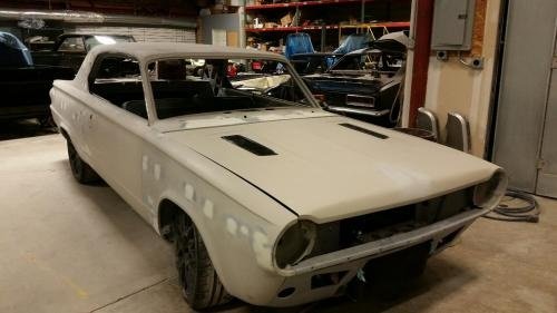

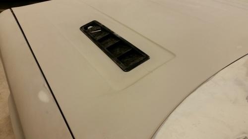

One down, One to go. Wasn't to tough to get fitted. It worked out the the under hood bracing just needed a little trim to get them to fit. I think body color now that I see them flush in the hood.
So cut the other side of the hood for the heat extractors. I think they will blend in nicely. I think I will send them out to have them copied in billet aluminum. These are just to cheep/ flimsy for me.

I had the same idea about adding hood extractors a few years back but the hood almost complete and didn't want toad more time to the body guys prolonged completion date. I think that they really look good, flimsy or not.
