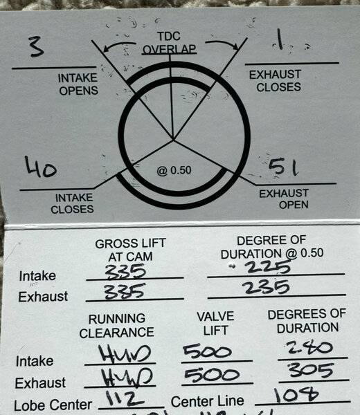

Going with 8.25 I got already there front discs 3.73 gears kyb gas a just
The cam is here sitting next to my bed so I’ll just run with it here is the card
Running 727 3200 stall just need to find a converter used or new don’t care as for the rods the 340 ones I picked up for $120 they’re sitting next to my laundry bin heads speedmaster 2.02 intake 1.88 exhaust heads on there way got em for $750 for the pair no complaints will see what can be done with them.

Uh oh will the 112lsa cam profile not be roudy at all will it be embarrassing :)
i mean, it's gonna have way more lope than a stock cam.
but that's a bunch of duration and lift that you're gonna need gears and stall for. i think you have the compression covered, probably.
i share rumble's sentiment that the cam is poor match for the rest of the combination.
A stock LSA is 114, at 112, it’ll still sound smooth, but not stock. Don’t worry about it, run it and have fun.
110 is the typical cam that has a chop sound to the idle.
The .500 lift is not Taking advantage of the cylinder heads air flow capabilities. You could port the 318 head, save money, out flow the SM heads and make more power.
The duration is fine. You’ll make power up to approximately 5500.
If you strip test it. Shift there and run again. Shift 300 rpm later. Check et & speeds. Try again and shift at 6K. Check et and speeds. Rinse and repeat at different rpm’s.
It’ll be a fun engine. Worry not.

There are better suited cams than what you've got on hand - make sure your chosen parts complement each other
