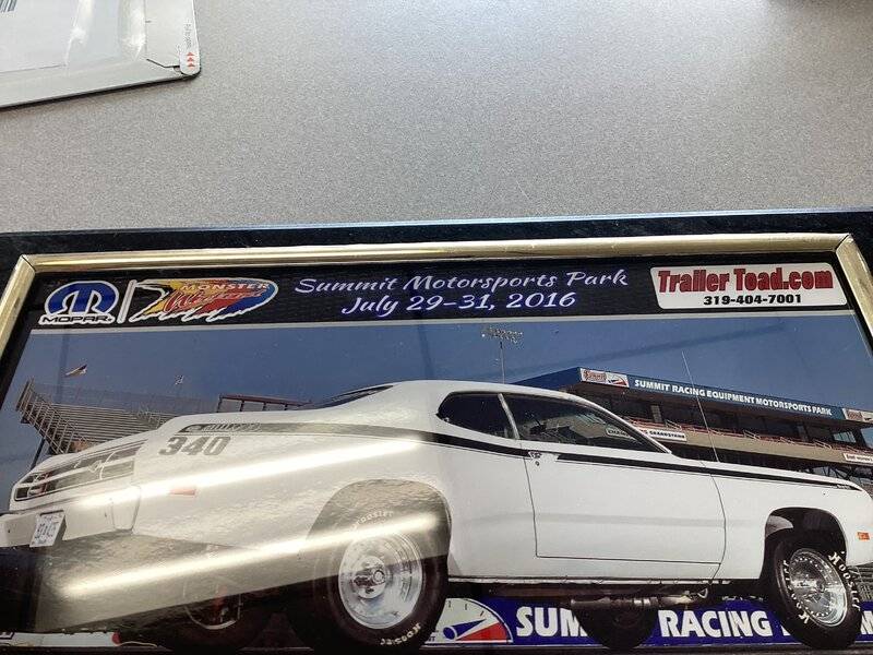

Do you still have it or have any photos/ videos?
Picture of car, but none with the hood open.
Painted metal bumpers, never did change them out..Ugg!
