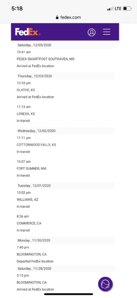

Could be worse I guess, my tracking info is “pending”. So it probably hasn’t been shipped yet. Lol
My heads are bouncing all over the country!!
