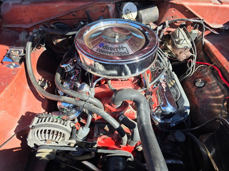

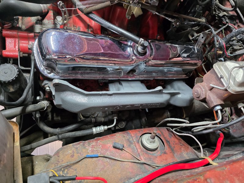

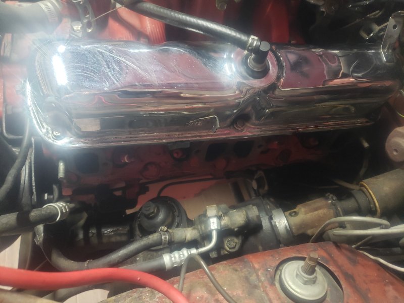

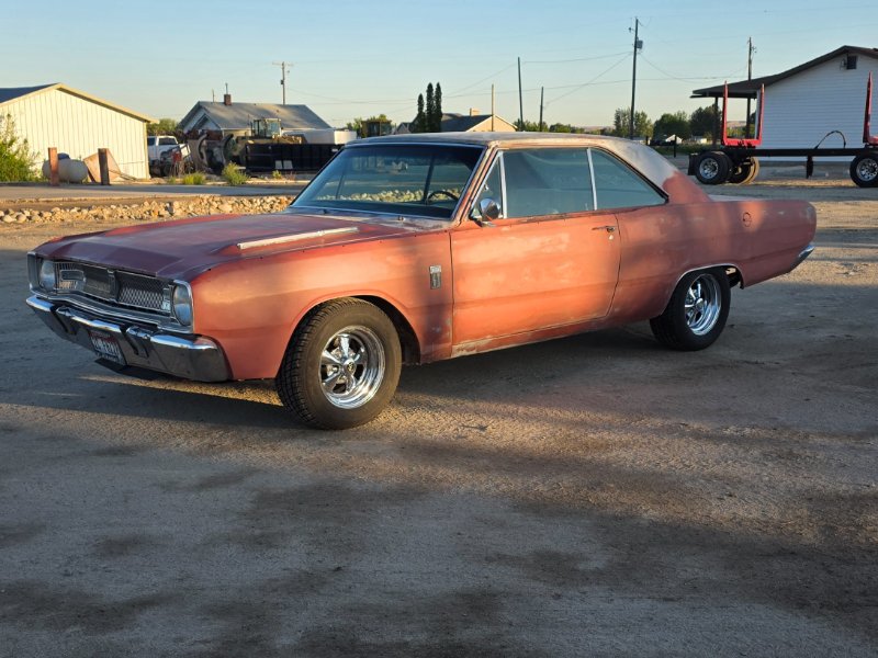

I had some spare time today to remove the manifold and get ports cleaned up.
I had to unbolt master cylinder and move over to get it out. Very tight.
I put the exhaust manifold on and since all surfaces looked nice I went the no gasket at head method, only a thin layer of high heat silicone. Cometic pipe gasket used. All went well and the TTI front pipe lined up perfectly. So all good day.
I put the exhaust manifold on and since all surfaces looked nice I went the no gasket at head method, only a thin layer of high heat silicone. Cometic pipe gasket used. All went well and the TTI front pipe lined up perfectly. So all good day. View attachment 1716468836View attachment 1716468837View attachment 1716468838View attachment 1716468839
