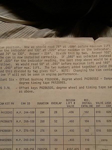

This is the sheet that came with My "6681" kit, note the lash & centerlines

Then the specs published in the catalog, which are not the same at all.
Which ones get published &/or repeated & by whom?
...and which ones are RIGHT? All of this has plagued Mopar guys for decades. It's the MP "just run it and shut up" thing. lol
I go with the sheet, and when I cracked the K6 mill open a couple back to try diff pushrod lengths/rocker shaft heights, the centerline checked in @102.5deg ATDC. Right where I left it. I settled on .019" on the intakes I believe.
Obviously as most "semi hot"-hot cams usually go in/are ground 4deg advanced & the LSA is 106 it kinda calls itself out, but the smaller ones...then there's the "3 different recc'd springs" for the "6681".....sigh....
