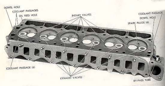

I noticed from this picture that there is a coolant passage near the last stud I’m trying to get out.
Do you think I could get the red nozzle on my Kroil can through the coolant passage hole to the back end of the stud and soak the threads from the inside?
^The answer is no
