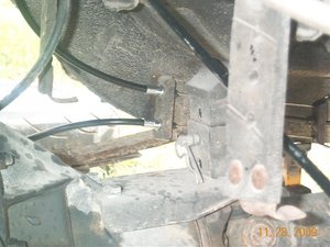

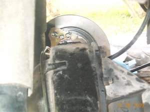

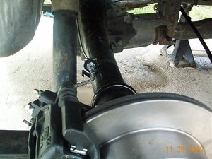

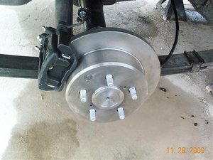

This is when I installed these Last week. They are Doctordiffs Rear brake kit and got the parking cables.

Nice, I looked on the website but didn't see any pricing available, if you don't mind, what's that kit going to set me back for???

They are $525.00 with out the parking brake cable and an additional $ 100.00 for the cables. Kit includes loaded calipers, Rotors, Mounting brackets, stainless flex hoses with bango bolts, copper washers,retaining clips and the tabs that either have to be welded which I did or he can be bent and hose clamped. I decicded to weld them cause it looks better and I know there not gonna move.
