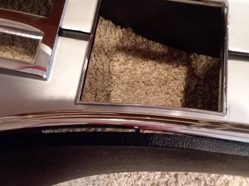

Got the console done the other day. 6-32 screws worked perfect for the storage compartment door. The door is still a little warped. It touches the console in the center but sits up on both ends. It doesn't look bad. Who knows, some of the factory ones might have been the same way. Overall I guess I'm happy with it. It's much better then pitted original ones.

Would like to see close ups of the fit and finish and paint quality if that's possible
There are some sanding scratches in the chrome. The storage compartment door had a couple defects that were sanded and then painted over. You can still see the sanded areas. The quality is definitely hit or miss. If you can look at these in person before you buy that would be best IMO. The sanding scratches in the chrome aren't that noticable unless you are looking for them. Someone looking at the console at a show will not notice them. The warpage of the storage compartment door looks worse when you are up close and looking at it from a level possition. It looks fine from a higher angle. I've found a lot of reproduction parts have issues like this. It isn't isolated to these parts. PG did treat me well. It was over a year since I took delivery of the parts. They could have told me to get lost.

The first set of parts was way worse then the second set. The automatic top plate was really warped/bent and stuck up 1/2" or more at the back. It didn't even fit on the sides. There was a gap between the console body and the top plate. The replacement fits like it should in this area.
These are the original ones that PG agreed were defective.
