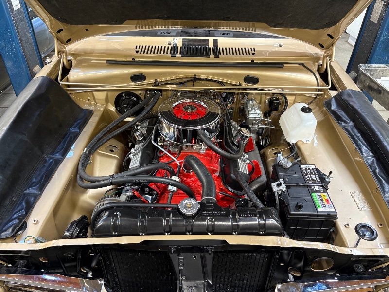

Here is a recent picture of the engine compartment of my FS. Note the top radiator hose is a Gates 20386, as is the bottom hose. In my opinion, it fits very well and looks original. Period photos below for comparison.

Did you try the 20386 on the top? It looks perfect, just like the pictures in the road test articles. Its not an AC hose in this application, I can't speak to other uses. I'm fussy too, I want an original look, the 20416 looked terrible, very non-original. I'll post a picture when I get it back together again.
Yes, that's the answer! I went ahead and got another Gates 20386 lower hose to use for a top hose. You cut off 2 1/2 inches off the thermostat cover end and it fits great! it's all stamped and ready to install now. I'll post a photo when it is. Thanks! :thumbsup: :thankyou:
