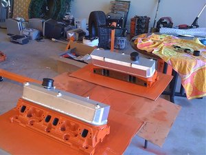

I think you are going to be really happy with those heads. That rocker arm to valve tip geometry looks great!

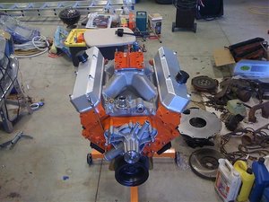

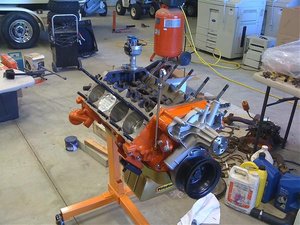

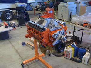

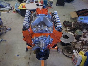

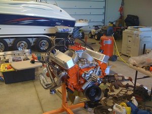

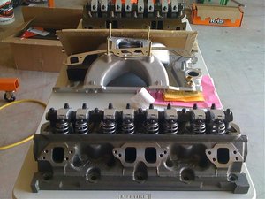

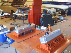

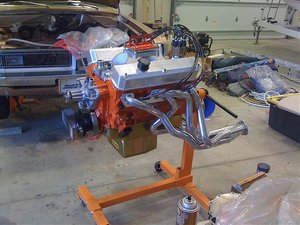

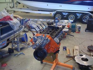

Here are some pictures. All I need is the pushrods which I will order first thing tomorrow. Then it is off to the dyno Dec 4th. Installed in the car on the 5th of December.
