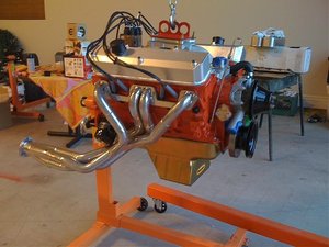

Adjusted the Valves again to make sure eveything was good, did some checking over of Valve Train etc. I mocked up the intake with the MP gaskets and all looked good. I put the silicone on everything and went to put the bolts in the intake and they didnt line up SOOOOOO I pulled everything back off and cleaned everything back up. Decided to measure the thickness of the gaskets and they were .075 thick. I had another pair of Mr. Gaskets for the intake so I measured them and they are .060, so Mocked it up again looked good so I re did the silocone and BAM it all went together. I am just about ready for the dyno. I will be making an engine dolly out of an engine stand using the lower portion of it toward the wheels so I can leave the headers on it for the trip on the road. I will try to get it done tomorrow.
Here is the engine as it sits now with everything just about done.
Two things:
You don't have to run the 90* filter set up with those headers. The shorter straight set up works well. Less chance of leaking that way too.
You have to pull the motor mount brakets off to get it on the dyno cart.
Looks really sharp.

Yeah I thought the 90* adapter could come off. I like the idea of running a bigger filter, but I have some shorty's on my shelf. Could probably get away with a bigger filter why it is out of the car.
I was thinking that the motor mounts and brackets would have to come off.
Thanks for the heads up!!

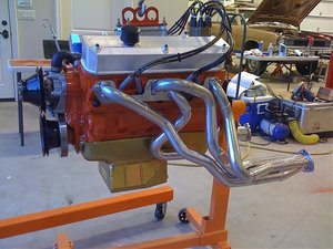

lookin good!
I had the same problem with .060 felpro's... so I used victor syle .030 thick magnum intake gaskets and it went right on.
looks very nice! post up those numbers for us man!

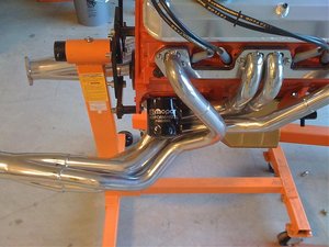

Took off the 90* filter and used a shorty filter. I kind of like the idea of a bigger filter and that the oil filter is further away from the exhaust for heat purposes with the 90* adapter. I wonder if it makes a difference?? Also took off the mounts.......and put on the 90* hose from the pump to the intake. I will do the dolly tomorrow and post some pictures of it.

I forgot one thing. Does the filter adapter plate have 4 holes in it or have you drilled an additional 4 holes for a total of 8 in it. That will help the oiling system a bunch.
