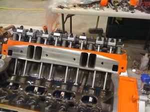

I thought you had the pushrods??? I have the length you need
I do have them for the magnum set up Ball / Ball. They came in at 7.650......
The new ones are Ball / Cup with an over all length of 7.400
I am going to get them hardened .135 wall with holes in them so pressurized oil will be at the cup.........Brian at IMM suggested that!

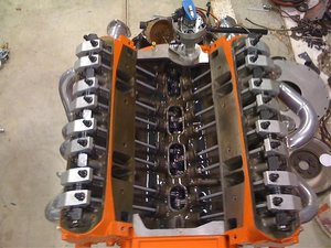

Have you bolted your TTI headers to the heads with a gasket and checked how well they crush the gaskets? I had to widen the flange bead on the out side tubes on my TTIs to get them to seal. TTI is suppose to have a new larger tube header out to address that issue.
Would you have a picture of this issue?
My budy's 340 Ebody cuda spit out the 4sp linkage because the stock rubber mount 9brand new) failed. With 3.91s and 14" radials. The engine is only about 380hp. It's the chock and the fact that most new mounts are cheap crap. You can run any RH mount, but left should be the safe-t-mount or have a good torque strap.
Here you go. The inside tubes are fine, it is the tubes on the ends that didn't seal well.
Yes, I crushed them yesterday. I had to open up the gaskets just a hair but all is fine. My Headers are not very old and the flange that seals on the gasket is thick and actually notches around the bolt holes.

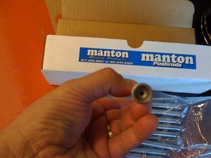

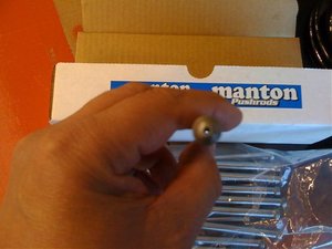

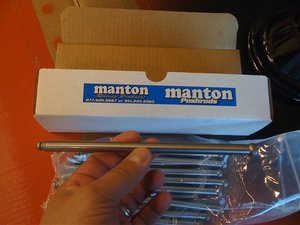

Got the push rods from Manton. They are a pretty sweet piece!!
The push rod pinch area on the RHS Heads WILL allow the use of a a 3/8's pushrod.
I ordered 3/8 push rods .095 wall with 5/16 Ball and Cup ends that OIL THRU so the Rocker Adjusting Ball and Push Rod Tip will have pressurized oil. Brian at IMM engines suggested this trick.
I ordered these at around 10:30am and picked them up at 3:00pm TODAY! That is FAST!!!
Here they are..
Those look nice. Brian also suggested to me that I run oil through push rods which are working well in my engine.
Me too on the Hyd roller I have but manton sent solid pushrods... We got it figured out. Terry took care of the stuff no issues.
