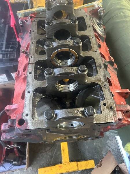

Played pond hockey this morning, worked a few hours then came home and stripped the engine down . Just in time to watch USA vs Canada .
