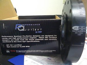

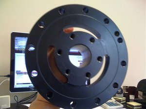

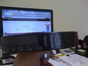

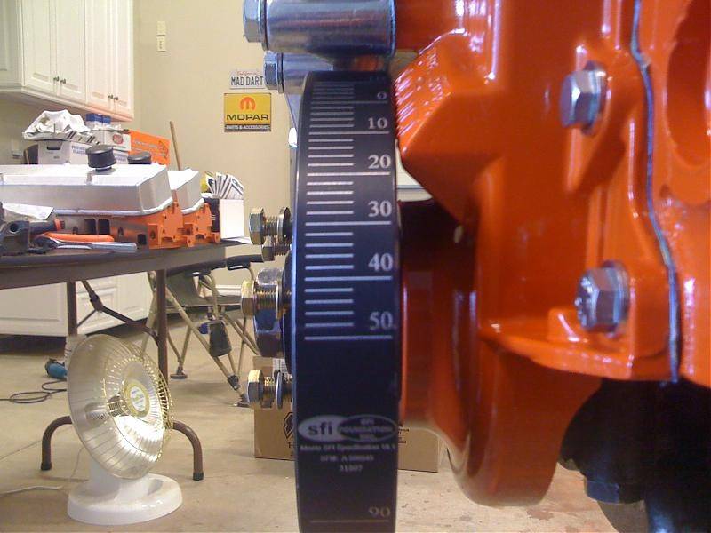

Just wanted to let you fellow MOPAR NUTS know that I purchased the SFI Damper that Fishy68 aka Tracy recommended from PRW. I am using it on the 318/402 stroker that I am building right now.

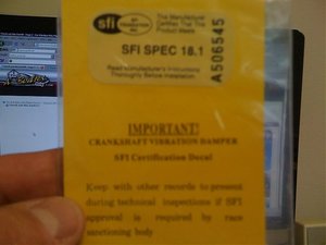

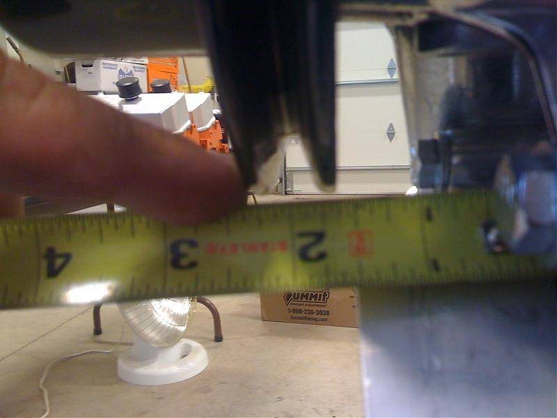

It seems to be a very well made piece with etched timing marks at -10* to 50* and 90*, 180*& 270*. The SFI approval is also etched into the unit. It also comes with SFI approved documentation to show the track officials if need be. The thickness of the damper is like factory along with the 7.25" diameter. Looks like the so far ALL the accessory pully's and belts will line up. It is a Very nice piece and the price is really good at $129.00
It can be found here.
http://www.prwonlinestore.com/sfi181approvedracingandperformancesteelvibrationdamper-2431801.aspx

The Damper seems to fit well on the snout of the crank, I checked it out this morning.
Buttttttttttttt

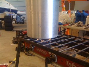

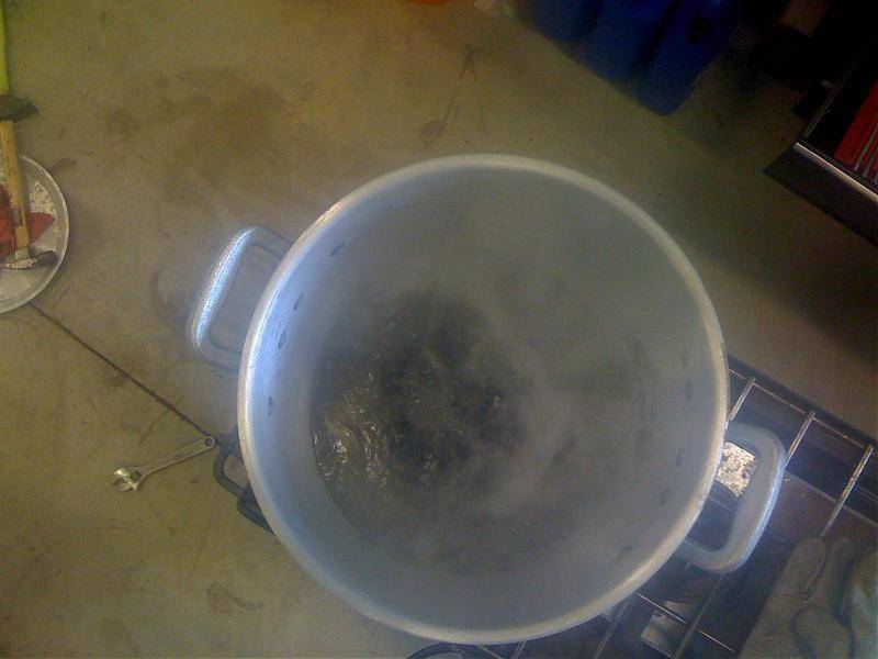

since the directions tell me to heat the damper to 215* in an oven or boil in a pot of water, I will have to put it on tomorrow. Dont have a stove in the Shop so I will use my TURKEY Pot filled with water and my Propane Stove to do it!!

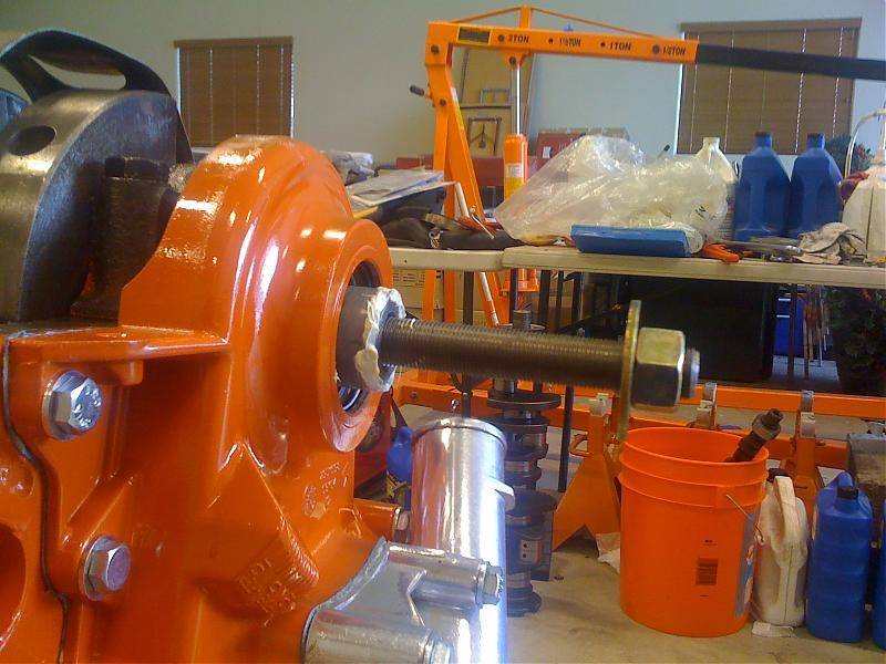

Use a "Balancer Installer" instead.

Why would the directions say to heat it?? They don't know WTF they are talking about?? Well lets see the temp in the Radiator sees around 200* at times I would think that the Block, Balancer etc would get hotter than the water that is trying to cool it. I don't have a heat gun BUT I bet it sees over 215* all the time which is where It says to heat it to. If the balancer goes from room temp to 215* slowly it should not hurt it one bit in my opinion.
Oh and I have a Balancer installer!!

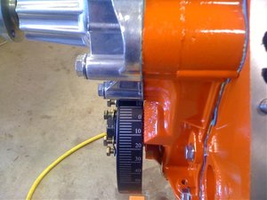

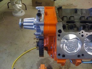

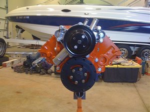

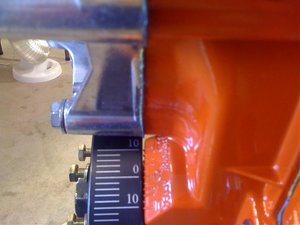

Ok it is installed. Here's the process. I ended up boiling it for about 15 min.
It installed very smoothly and everything lines up perfectly. I even checked EXACT TDC and it is right on the Money!!

Just so you know the Bolts that hold the Pully on the Damper are FINE Thread 3/4" Long 5/16" -- 24 Thread Pitch. The Factory Bolts WILL NOT work! I went to Ace Hardware and spent less than $2.00 for Grade 8 bolts and washers

...so it slid onto the crank snout all the way just by boiling it?
You didnt have to crank it down with the installer?
If so, cool.
No had to use the installer. It went on tight and smoothly. The heat must be to expand the metal? Only thing I could think of.

How did the index check out? - Was it right on the money?
Should be ok for a low RPM street car. Looks good.
Yes it was right on the money..........It is tested to 12500rpm so I think I will be safe easily to 7500rpm since I use to spin my 340 that high with the stock balancer!
