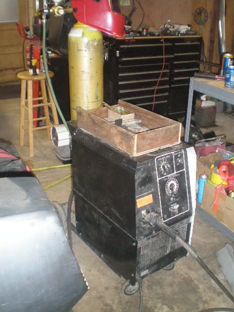

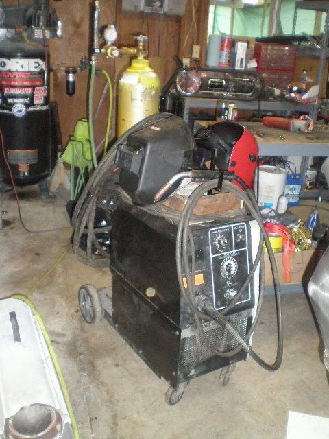

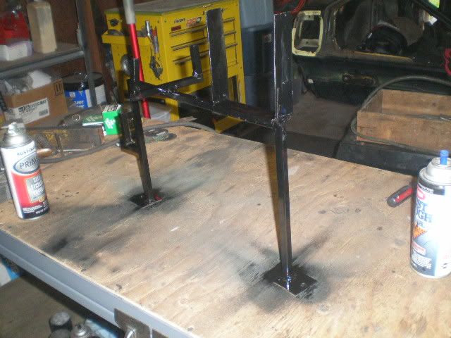

Started early, and decided to do my welding cart, came out pretty nice if I may say so myself. Quick, easy, effective.

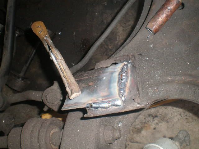

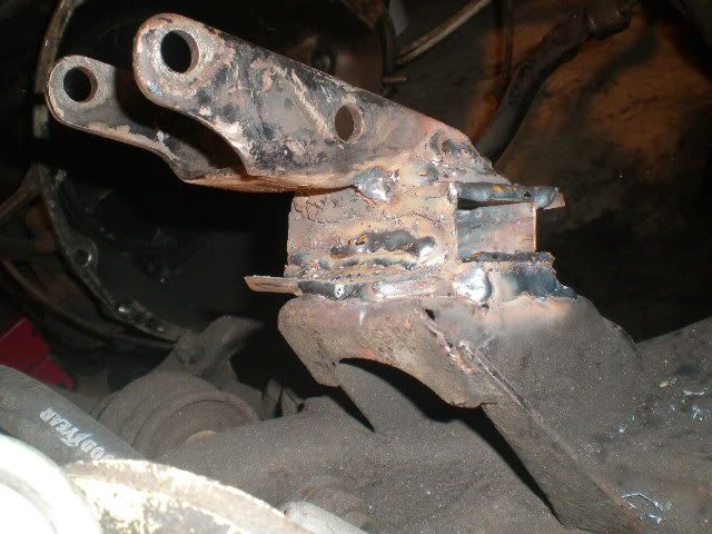

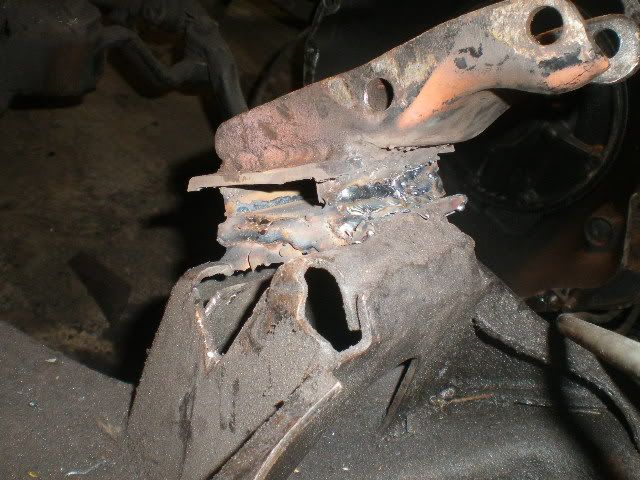

Than moved onto the motor mounts, got everything sitting in just right, pulled the mounts out solid welded the shims onto them, took longer than I expected had a lot of welds to redo, and I suck at welding.
Put the mounts back on the motor dropped everything in to tack the mounts onto the K frame where they are supposed to go, and somehow lost 3/8" at the heighth! Cant find where it went it just disappeared into thin air.
Actually now that I think about it the pass side of the crank reads 3/8" low, the drivers side only reads 1/8th low....still have no idea how it could have happened but until I figure it out I don't want to weld another shim on and have the same thing or something similar happen again, ill just be chasing my tail.

My crappy motor mount welding job, these are the decent welds lol

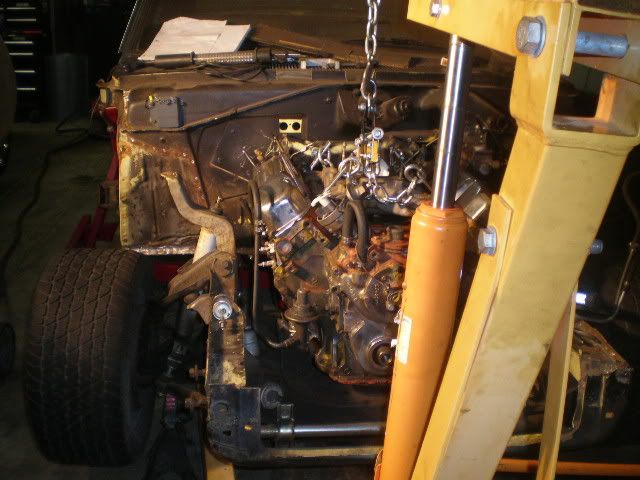

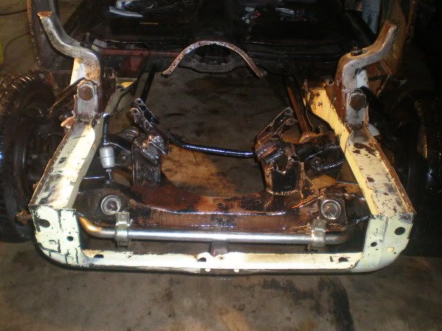

Finally got the motor mounts done, and let me tell ya, schumachers are worth every effin Penney. Had to do .25" shim passenger side and 1/8"~ shim drivers side. All together Im not sure I accomplished much with all this headache. Gained about .5" pass side and probably near .75" drivers side from previous mounting. Pretty sure I still need a hole in the hood, looks like a heater is possible now though, which is a HUGE plus.

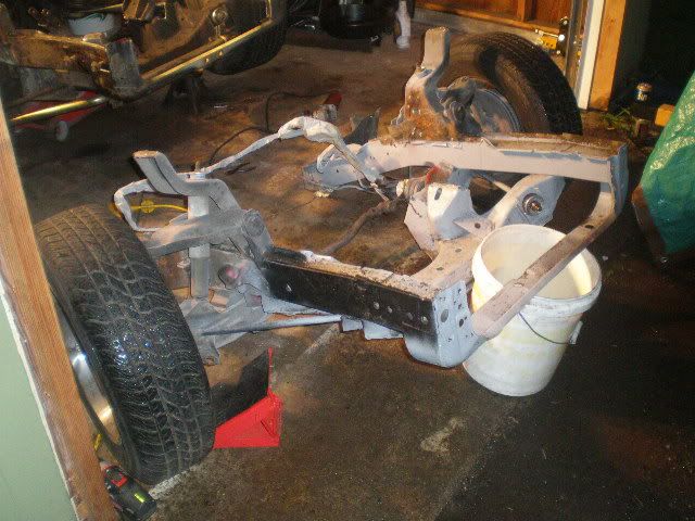

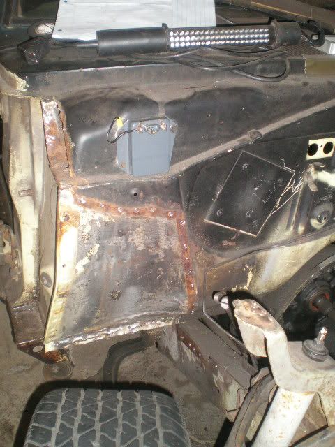

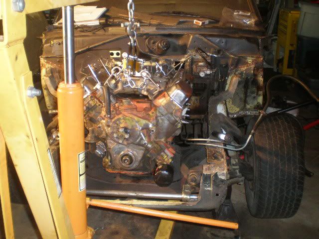

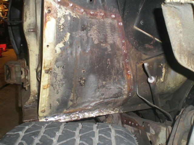

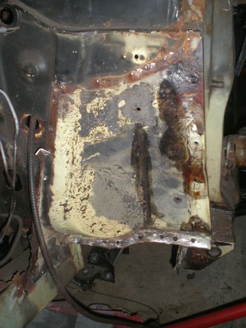

Today its prepping and removing the front clip+firewall from the donor, which shouldn't take long(hopefully) than moving on to pulling the current firewall and prepping everything for the new front clip to go on. Took some pictures of the reasons for firewall removal so you guys have a better understanding. Also throwing in pictures of the current motor position, no front clip so it'll be hard for you guys to see a change I think.
My welding is getting better, i'm sure the mounts just look like a glob of weld to you guys, but I figured there was no way in hell I wanted them to break, and I might as well use em for welding practice. Did come up with a nifty new phrase though :D
If at first you don't succeed, weld another bead. :D

Yup, all the measurements that I got from schumacher are within tolerance. If I have a problem installing headers after all this, this K frame is getting junked and ill buy motor mounts lol.

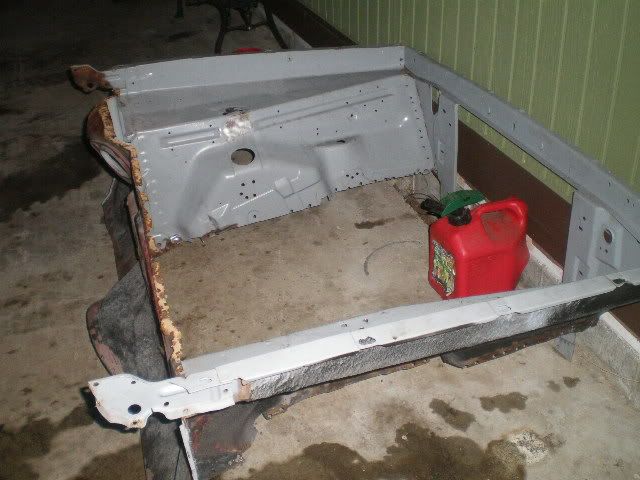

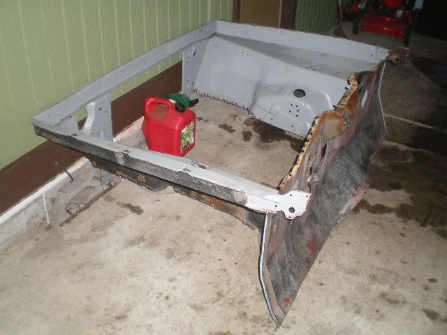

So here's tonight's update, the front clip+firewall is off whats left of the shell and ready to go on my car. Came off better than I expected, very time consuming. Playing the "Wheres-the-hidden-spot-weld-that's-holding-it-up" game isn't fun, but it came out pretty decent, have a couple areas that im going to have to repair because I had to drill 3ish times to get the spot weld clear, but nothing thats too big of a deal.

Been working a lot last couple days, just did'nt have anything worth taking pictures yet. Firewall is finally out and degreased front end with easy-off oven cleaner. Not impressed, was hoping it did what everyone said and stripped paint off, the only thing it did however was work like a really good, nasty, expensive, messy degreaser. Not a big deal, just means ill have to grind and wire-wheel everything, but was really hoping for it to make stripping the front easier. Next up cleaning under the interior side of the cowl now that I can get to it, the subframe, yanking off the Kframe and upper and lower control arms. Basically getting it ready for the front clip to go on it.
