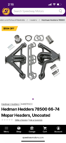

Anyone have experience with headman 78500 shorty headers with a 360 la in an A body? I heard they fit in an A body with power steering with no clearance issues.
I have some long tube in my ‘72 Duster with a 360 but they don’t fit well. I believe all the heat caused my steering gear box to leak plus there are many clearance issues.

They're headman tight tubes...sorry I thought your car had power steering
We had a member who modified those Hedmans to fit an early A body. The passenger's side fell in but he had to relocate the #1 tube to the #3 tube just before it went into the collector. No P/S of course. But they fit the later A bodies fine. Read the footnotes on the Hedman site. It's all there.

They are really low quality.
I have a friend with a set on a b-body and had to move the flange around for clearence. The headers developed cracks and flanges are very thin.
He finally dumped them and put TTI shorties on.

Are you sure you're talking about the same headers? They have .310" which is basically 5/16". That ain't the monstrous 3/8" some are, but it's pretty thick. I have a friend who has a big block set on a C body wagon and they're pretty nice.
Yes headman’s.
He drives the car regularly. I think had 20-30K miles on headers. They just had all kinds of quality issues.

That's surprising. And sad. Hedman used to make a good product.
one of the few still privately owned companies and still built in the states.
i haven't owned a set in 20yrs but they used to make really good stuff. especially their truck headers.
