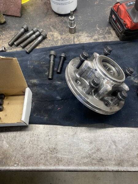

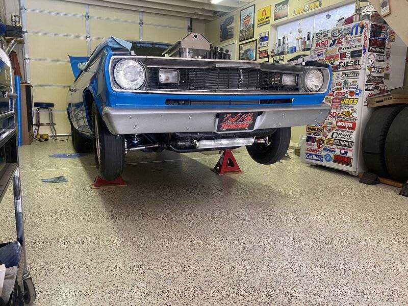

Unloaded the ride from the trailer. I’m not gonna lie, I rather enjoyed the free space in the garage. Oil changed, lash adjusted, new set of valve cover gaskets. I finally swapped out the 8 mile long front wheel studs that have been on the car forever. Not sure why they were on there but the look is much better now. I’ve also come to the conclusion that the K member is bent on the right side. Got a call in to my chassis guy to take a look at that along with a couple other things. Fault totally mine… somewhere the right rear K member bolt ended up missing. Needless to say hitting the brakes at 145+ put some undue stresses on things. Hopefully get things done sooner than later.

Do you have a tubular K-member on your car? I had the same thing happen to the 72 Dart that I had prior, except it was the front right bolt came out and it still had the factory K-member that had been modified to accept a rack/pinion setup. With the missing bolt the back side of the K-member finally cracked and that was an that got my attention! Thankfully I wasn't making a run at the time but was backing up to my trailer after a run. Went with a Tory Shellehamer tubular coil over front suspension after that.
I do have a tube K….. and it’s very light, and on the delicate side. Comp Chassis in Phoenix builds them in house, and Mike made it perfectly clear….. “race car stuff!” It’s actually worked flawlessly until my stupidity interferes with its performance. I destroyed one on the bumper dragging episode, and now my letting bolts fall out has done this one no favors…… Tory’s set up is very nice. I contemplated about contacting him to see if my GM spindles would work with his stuff, but we’ll repair and move forward.

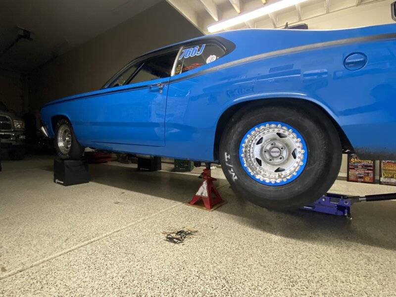

This sucks…… my “go to” chassis guy is between shops so I’m on hold for K repair. All my west coast gang are in Vegas for muscle cars at the strip and here I sit dead in the water. In the mean time I sent my Convos to MacFab and let them do their magic. I hope the ole side chick appreciates the jewelry :) . Also added an Auto Meter AFR gauge on the right bank. If nothing else I can compare the Racepak reading on the left.

Car looks excellent with the blue bead lock rings.
From western AZ to NC and back shipped them Feb 29, got them back March 13.
…..and they already served me well as apparently when I removed the tires at work on our POS tire machine I dinged a tube. was nice to pull the ring and swap a new tube in. I’ll patch the other and it’ll be my spare.
