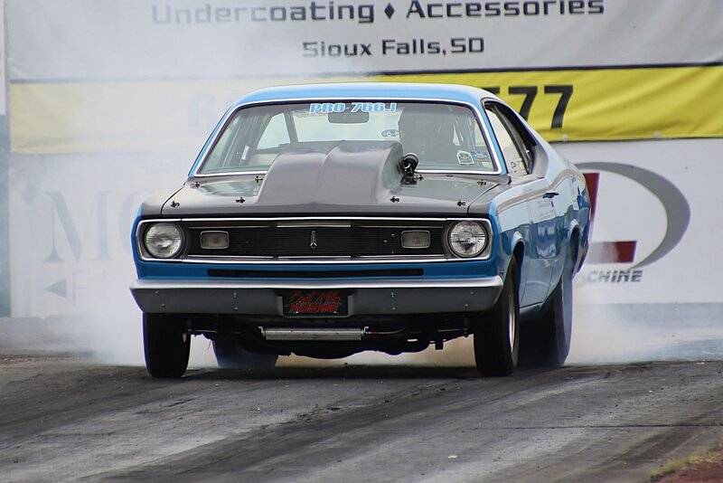

No wheelie bars!! I trust the shocks!! (Of course altitude has a calming effect too). That’s as high as she goes these days.
how do you have your suspension set up? i think my car will perform close to your car with the W8. i haven't made a pass yet but i'm hoping for 9.10-20's. i do NOT want to buy wheelie bars and it looks like you have your car figured out.
It’s a ladder bar car. I had Strange single adjustables in the front and Afco singles in the back in the wheelie days. My front end only has 3” of travel. After the wheel stand I reached out to my “shock guy” in SoDak and he had Eric Safell at Afco make me some double adjustables for the front. I sent them back once and he revalved them and since then we’ve only touched the wheelie bars on a couple of occasions. If/when I go to Famoso I’ll definitely run them. It’s close to sea level. I still run singles in the rear.
i have brand new single adjustable QA1's on all 4 corners with new springs. ladder bar car as well. i'm not sure how the car is going to launch with the new engine.

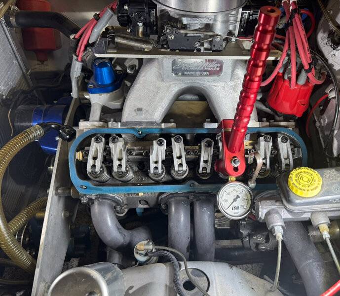

Finally got around to looking at the car from MaTS….. found the culprit of the mysterious noise as #7 intake adjuster broke. Everything was in place and absolutely no glitter in the oil up in the head. Not sure “why” this occurred, but I have a few sets of rockers to steal parts from so it’s back together for now. All the valve springs checked out so we’re just waiting for some new valve cover gaskets to arrive. The old MP gaskets were starting to weep some even with the vac pump. Not sure when we’re getting out again…. off-roading season has really overshadowed any racing we do anymore.
Good catch finding that broken adjuster.

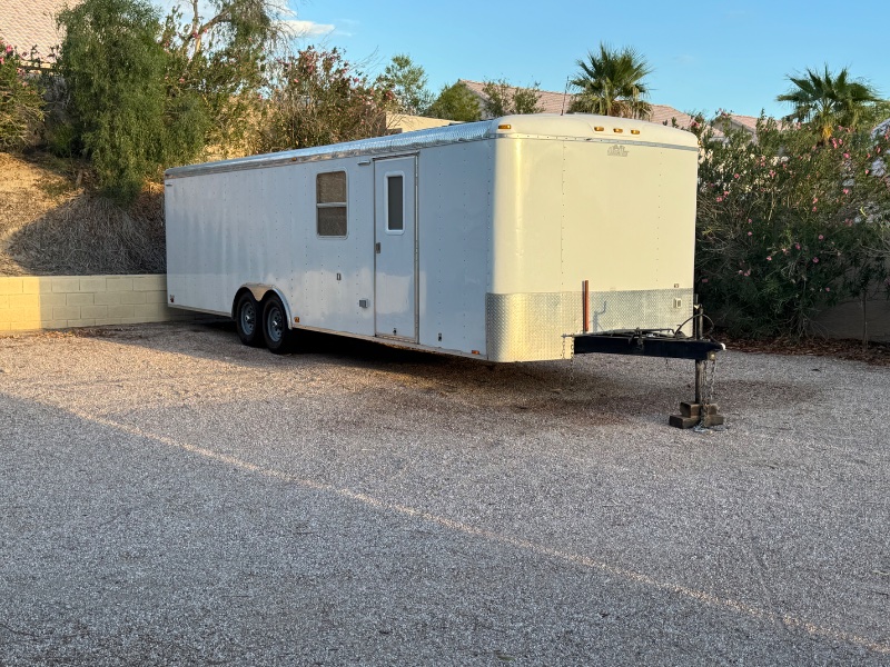

October…. Our “false fall” month has arrived. Been starting to look at a newer trailer. While this 16 year old Cargo Mate has served us well with only a couple structural hiccups, we’d like something a little bigger and taller to accommodate our SxS….. basically a toy hauler capable of hauling a car. The torn shackle (one on other side was cracked) was an interesting deal. We started getting tire wear on the RR and it always ran 10-15 degrees warmer. I’d also damaged a side panel on the left side and found a trailer repair place to have this taken care of. After determining that everything was still square they suspected the rear axle and I made the call to replace it. While it was apart they upsold me the Dexter EZ flex equalizer and wet bolt shackle kit. Ton of miles on the rig and there was definitely some wear on the OE dry set up. Long story short…. and I do mean short, just shy of two years after this repair I was leaving for work and was going to put the tire covers on (got in late the night before) and I could hardly get my hand between the tires on the right side. After some serious research on leaf spring trailers i finally figured it out. They installed the Dexter EZ flex for a 33” axle spread…… our trailer is a 35”. So basically my axles were in a game of tug-o-war with each other. I’m neither a “welder” or a structural engineer, but to be honest for the weight involved those long shackles always kind of bothered me for the weight involved. Welded one new hanger on and I made plates to overlay all of them. So far it’s been doing just fine…..
Funny you should mention looking for a trailer.
I’ve started down the rabbit hole again of trying to determine if I want to get a trailer for my car. I only live 14 miles from Barona drag strip and drive the car there, swap tires, make passes, swap back and head home.
Might start venturing out to other tracks now that the boy is in college which would land me in the trailer buying decision process again. There really isn’t crap out here for used trailers and most of what pops up is either in Arizona or northern California. Then there is the “can I pull a smaller fifth wheel with my CCSB Ram”, what kind of freaklin license is CA going to make me get, what type of axles should I get, etc.?
I’ve noticed, and yet still surprised, every time I do this how many **** design trailers there are out there. Many seem to use the “Hold my beer” style of design criteria and look like they were welded together using coat hanger wire.
So for now I’ll keep perusing Craigslist and Racing Junk hoping something pops up from someone with big bucks upgrading!
