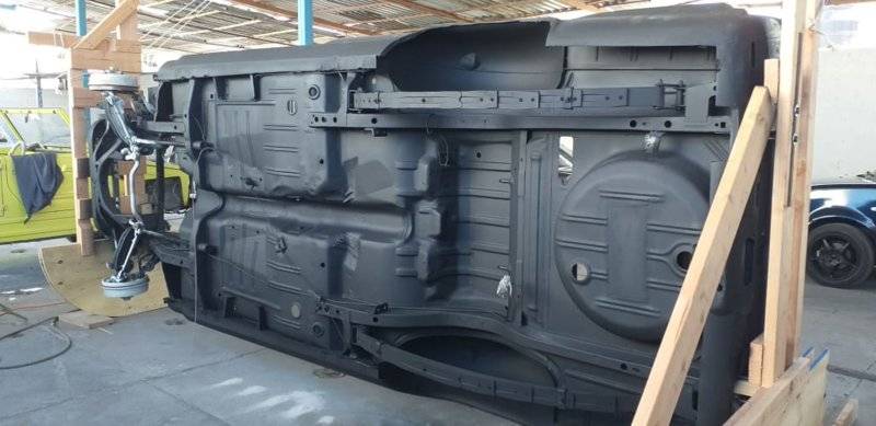

It's a pain in the *** on jack stands. Wish I had had a needle scaler. Used a torch, scraper, screw driver, putty knife, whatever I could lay my hands on. The sandblaster guy was able to remove the few remaining remnants after my attack was completed on the '65 Formula S.
At least by the time it was ready for paint I had sense enough to roll it on its side.

Best money i ever spent. Rotisserie then sand blaster. 3 hrs later the underneath was spotless. Epoxy then raptor bedliner. Id do it again in a heartbeat
