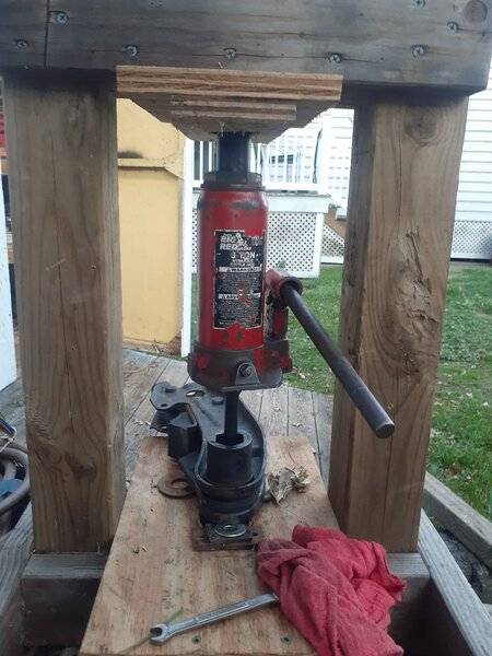

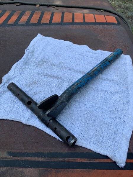

My spring remover made many years ago

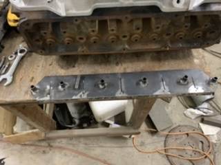

Just made, for drilling Magnum heads to LA bolt pattern. (Using 340 manifolds )

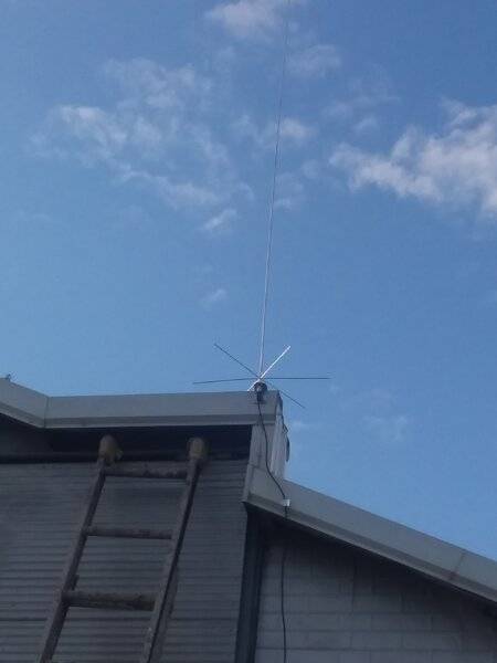

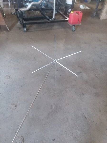

Made up a CB Radio base station antenna.
9' Whip and 21" diameter Ground Plane, mounted 16' up off the ground on the front of the shop.
Next step > raise it higher yet. Higher up = more distance.
Big improvement so far, getting it tuned in.
Call this making "communication tools".

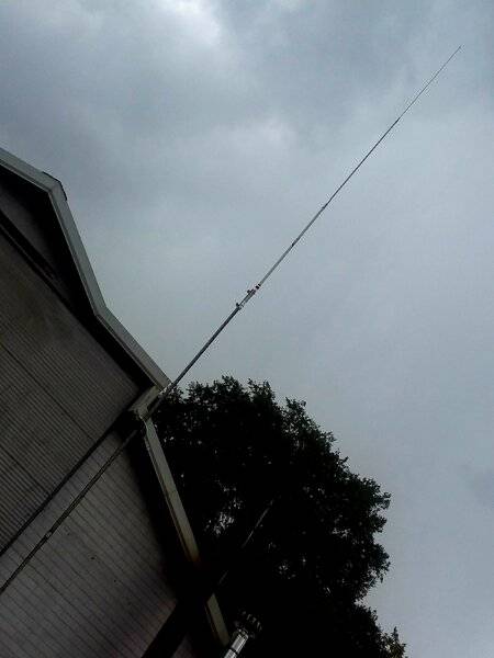

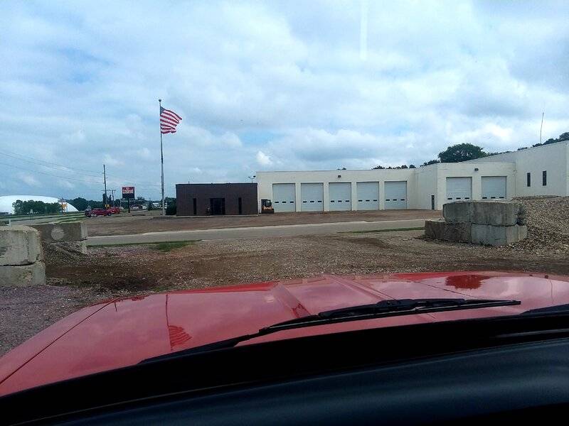

Taking things to the next level of experimenting. Now installed a professional grade Base Station antenna at the optimal height of 36'. Swapped this out from my home made antenna.
Has increased my range from 3 miles to 12 plus miles. Here is a pic of me recieving the base station signal with my '76 Truck's Cobra CB and 9' whip at the town of Dundas Minnesota 12 miles South of my base.
At the end of the day I did a radio check on channel 19 from my base. Immediately got a reply back from a guy with a base antenna like mine from the North West 14 miles away just South of the city of Apple Valley.
This guy and 4 of his other buddies are all into CBs in the South Twin City area, we exchanged info and will be looking to communicate together more in the future.
Pretty nice, that's a 25 mile diameter to be able to communicate with others.
Loud & Clear

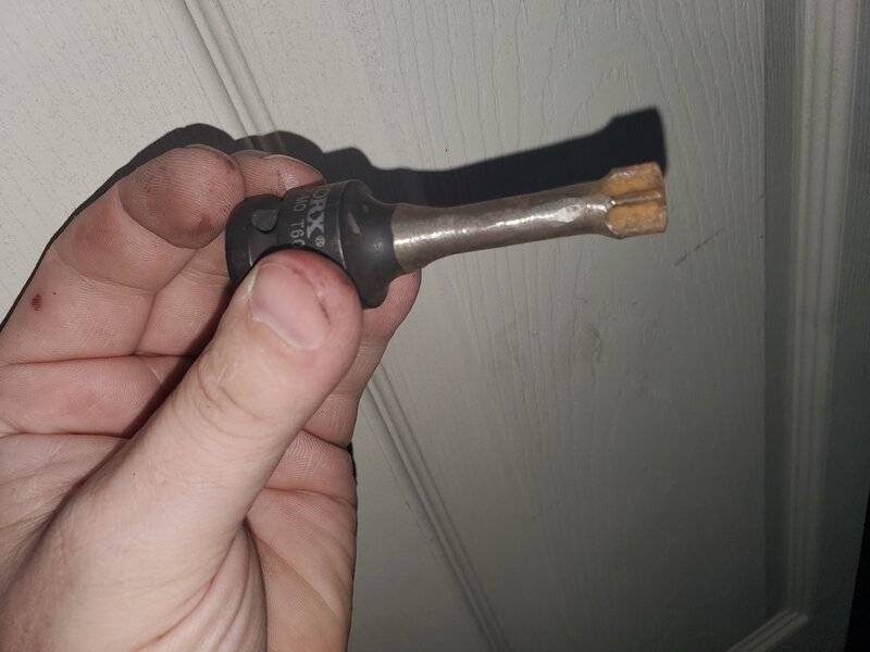

Need one of these to get the rear hubs off in order to slap new rear wheel bearings on a fomoco
They run about 60 bucks
Or I can grab a 7 dollar socket and spend 10 minutes with a bench grinder

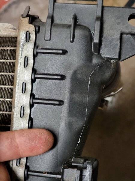

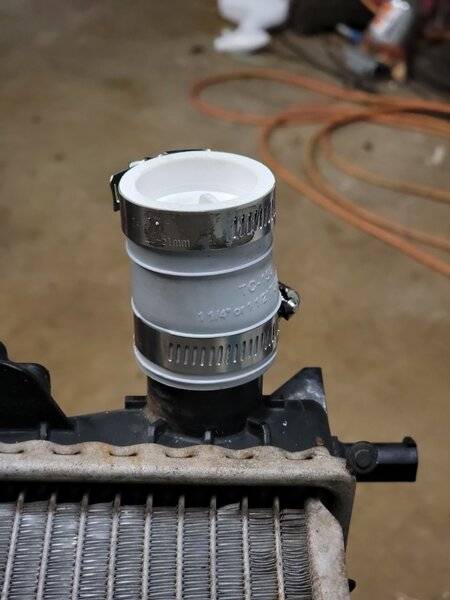

Something I whipped up to find a leak in my 2012 Caravan radiator (WTF, are these vans only made to last 10 years?). Bought a new one and the SOB leaks worse than the first! Have to pull it again and find the leak (low passenger side front i suspect. Plastic bullshit radiators, Ill get with the Amazon seller for a replacement. Only leaks under pressure so these plugs clamp on the upper and lower bungs and one has a Schrader valve to pressurize the rad. A few pumps with the cap on and a good ear will get you close. A squirt of soapy water will make any hole bubble. This one was split under the upper hose. I'll repair and use it for my break in rig.2x $5 1 1/2-1 1/4 tube couplers , 2 x 60 cent 1 1/2 knock out plugs and a screw in Schrader valve. Could probably use it on the vehicle too if you clamp one of the knock out caps in the removed upper rad hose and then the pressure cap on the open rad bung. pump it and watch for the leaking to start. The 13lb cap will vent before your rad balloons.
radiator repair kit that comes with 2 part epoxy and fiberglass screen. That **** works!!!!
Mine was slit from the top to about half way down. took two kits. not a drop on the ground sence.
