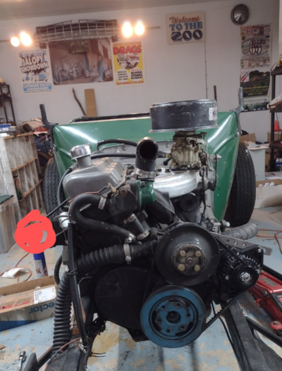

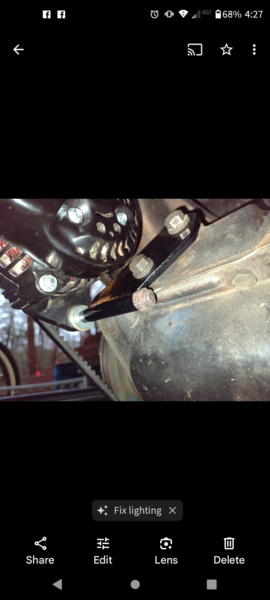

I made a new mount for the alternator. Thanks to @Badvert65 for the help. We only talked about it years ago haha and I finally got around to it. It used to be high and on the passenger side (red mark) now it's tucked in and low on the driver's side. Before you could see it sticking out past the grill.
Also replaced the timing chain because it had a lot of slop. Next I'm going to readjust the valve lash and reset the timing since it won't be jumping around now.
