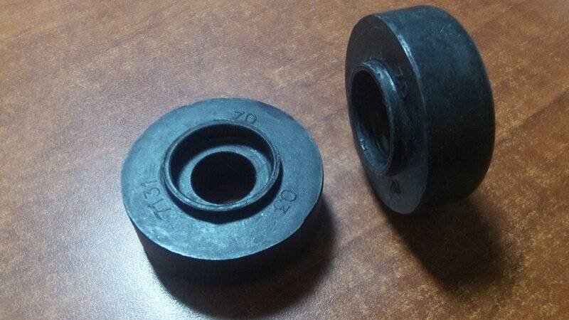

Well I went and took some pictures of some differences and the shear sleeves. The first picture is of a worn rubber without the sleeve. The second picture is of one with the shear sleeve,
Note the first picture the rubber is worn but still there. Poly nipple would be totally chewed up and gone.
The second 2 pictures are with the sleeve. They are the best strut bushings you can install. That sleeve fits tight in the K-member and never shears because it is a metal sleeve molded in the bushing.
The male side of the bushings always go in from the front
The next pictures are of early 72 and older The OEM is a one piece. The other one is a 2 piece for 72 and older. I have some of them from years ago. I like them better then the one piece but they are harder to find today. You cannot use poly bushings with the early strut rods they are not long enough. You need to get the later coarse thread strut rods

I’ve ordered a set of the Moog K7068’s also, but they have not shipped and do not have a shipping date. So just ordering a set doesn’t necessarily mean a thing until you’ve actually received them.
MOOG K7040 bushing kit has the molded in inserts.
That part # is for the ‘67-72 strut rods and will most likely not fit the ‘73+ strut rods because the earlier strut rods are a smaller diameter on the end where the bushing rides.
5/8" ID on the K7040 bushing
‘73+ bushings have a 3/4” ID.
Do you have a close up picture of the K7040 bushings showing the metal insert?
And, thank you for posting that information. Seems like there’s a solution for the ‘67-72 cars that’s easy to obtain and would match OMM’s recommendation. Just the regular Moog parts.
All we needed was someone to post a part # and some info! Easy!
I'd think one could take some kind of 3/4" rasp bit and carefully open these up enough to fit 73 up.
Lots of material in there.
It’s not just the diameter though. On the ‘73+ strut rods the shoulder that holds the bushings is further back, the later bushings were thicker than the earlier ones. The overall length of the strut rods was different, although the effective length is the same. The section that holds the bushings is longer on the ‘73+ strut rods.
