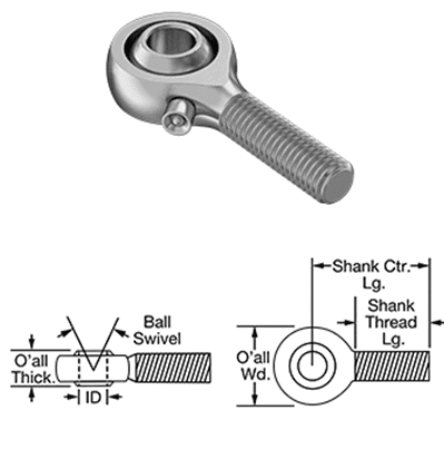

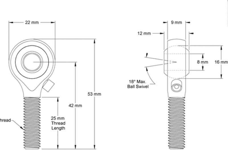

The do swivel. Many people use the slang "Swivel Joint" when referring to Heim Joints. But they are also called "Rod Ends", "Spherical Rod Ends", "Mechanical Rod Ends" or "Bearing Rod Ends". QA1 manufactures some of the best on the market, you won't see them listed as "Heim" joins by them in their advertising. Because they aren't the H.G. Heim Company that holds the patent.
Usually they are listed to have between 5 to around 20 degrees of swivel for most automotive application. Some are manufactured to "Swivel" on some Heim joints as much as 65 degrees. You would need to look up the manufacturing drawings and specs to know how much they "swivel", but they all do to some degree. It all depends on how much load you need them to carry.
The fact that they do "Swivel" is also the main reason they prematurely fail. If you were to have the axis of the ball close to the degree limit they were designed for (say 18 degrees in the attached picture), the rod end portion will dig into the ball. They work their best when installed close to 90 degrees so the loads are carried correctly through the race between the ball and rod end. I saw pictures on FAO where a guy installed Hotchkis upper control arms on his Challenger and did just that.

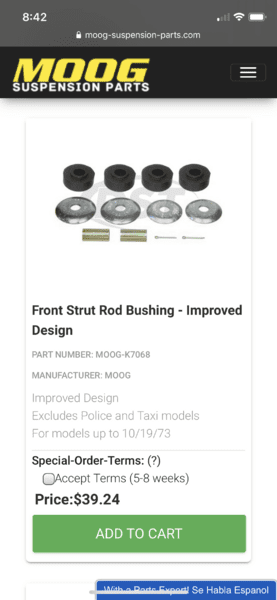

Moog is currently listing them as a 5-8 week delay, you have to accept that term to even place an order.
Amazon actually made me confirm my order again just now, they're listing as trying to ship by September 25th. Order has been pending since July 27th.

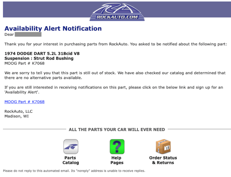

Just in case anyone here still wants K7068 strut rod bushings, I received this email from RockAuto yesterday.
