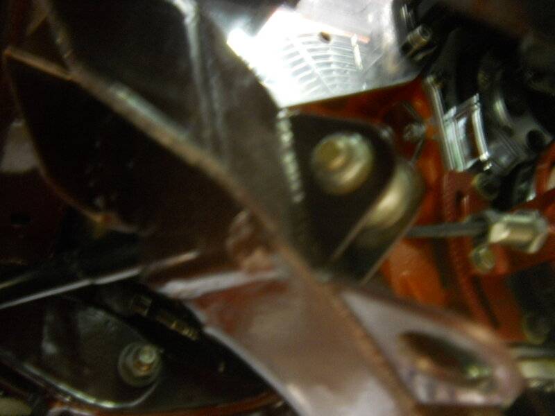

Those are the original strut rods with the original threads. All I did was added the hymn ends, They are turned so they pivot on the balls when the control arm goes up and down, I used hymn ends and the tapered bushings from our sprint car .
The tapered bushings allow full twist. I just wanted to eliminate the bushing crush when foot braking the car. Strut rod bushings cause wheel shake when launching the car off the foot brake.

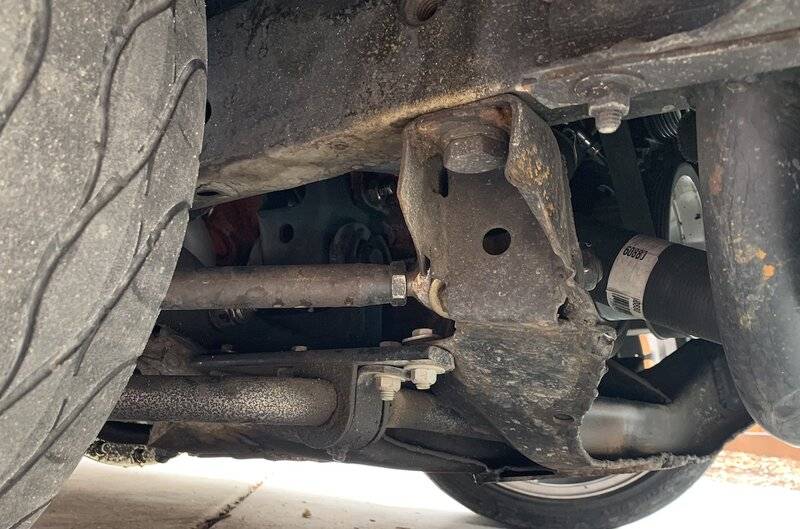

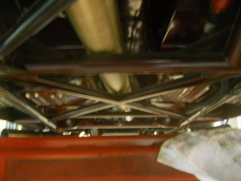

And of course, more pictures of that butchered K member that has never seen a single mile on the track or the street. But I'm sure it's the best one ever made. When you extended those strut rods and relocated the pivot point forward of the K you did check to make sure the resulting larger arc of the strut rod at the K frame would actually clear the K frame itself right? And of course a single pass weld on one side with no reinforcement is strong enough to support the strut rod, even with a larger hole cut out in the K.

And of course, more pictures of that butchered K member that has never seen a single mile on the track or the street. But I'm sure it's the best one ever made. When yoint, torsion bar, sway bar and shock failure that the rubber in the original LCA bushing would hold the LCA on the car. Not that it would matter with the tire folded up in the wheel well after the spindle was detached from the LCA, but what the hell.
That particular butchered K-member wasn't use. But you will find several on other cars. Its done for pan clearance and for reasons I gave. This car has the same butchered K-member. Plus many more built here at Ray Bartons in Pa. 68 Hemi cars have to use original suspension parts on an SS car in that class. They can be modified but have to be original. You are really an A$$. But mental people can't help themselves. Barton would grab you by the seat of your pants and throw you out the Door. Note the same K-member in this 68 SS car. This whole Dart is butchered in your eyes. But your piece of **** ******** blue challenger is the cats meow.
