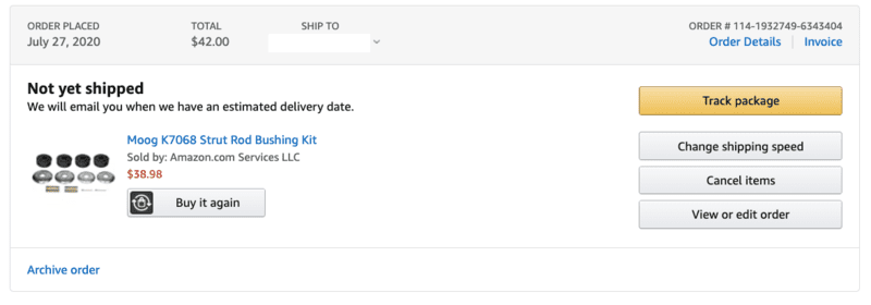

Well, that's not what my local Napa told me, and using the K7068 on NapaOnline takes you to the single piece bushing which is incorrect for the '73-'76 strut rods. So congratulations on getting a set of K7068's, but I did what you suggested and I can't control what my local Napa says.
And my Jeg's order is still on backorder, placed 7/17.
So is my Amazon order from 7/27.
