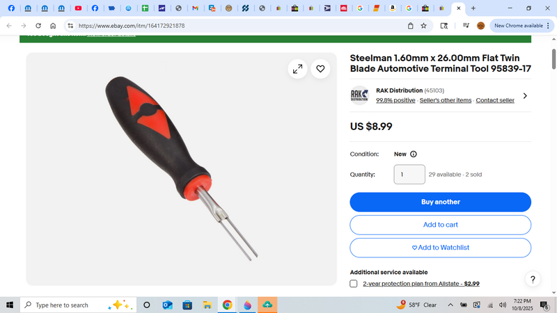

Matt, Those terminals look like the ones I am trying to release so I don't haver to cut or destroy. I can't for the life of me get them out of the terminal block. I am working with a turn signal switch and the terminal block is too big to go through the hole in the steering column. I have tried a release tool, a pocket screwdriver, and a o ring pick. I can't get the tab to release the terminal.

I was able to get them released with the tool. I had to cut off the neighboring tools so it would fit down in the terminal block. It has a release tab on the sides. All I could see is a tab on the backside and that is what I was trying to release. :BangHead: :BangHead:

They were but not any more. i modified the tool and cut 2 of the tools off. If my tool truck was still parked in the driveway I would have the right tool. I had a kit that had individual tools with nice knurled handles. I needed that today. Oh, I made a note in my FSM in case I forget.
Glad you figured it out Mike. I just got in. This seems to be the downside of the multi-tool . I forget what connector I was trying to use it on but the other tools were getting in the way.
I just need one tool not a whole set so I bought this one. It looks like it will work better than the Lisle Ninja Star tool I bought.
