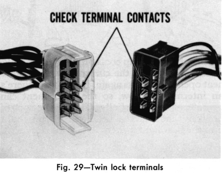

For the twin lock terminals used in the steering column connector, do you need to use two terminal removal tools at once since they seem to use two locking tabs per terminal?
I think something like this should work. (the double flat release tools)
Nope. The metal that the twin lock terminals are made of is super thin. I just take the same thin tool I use for female packard terminal removal and pry both sides in one and then the other. They then slide right out.

Hit another snag. Anyone know of a four-pin version of the steering column connector? More holes would be ok, but I need 4 at a minimum for my project.
Been spending an hour or two hunting the Mouser catalogue...not sure what options to pick to narrow things down since there's so many...what aftermarket connectors would be able to securely hold these twin lock terminals?

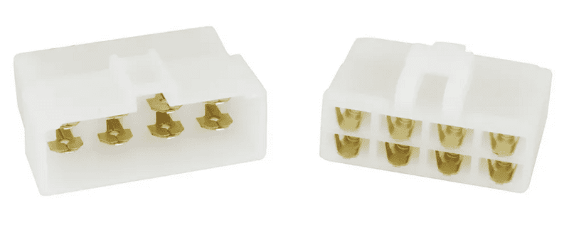

Oh they're not going to be freely hanging, I was going to replace the connector and terminals with this:
Pic seems to show the female terminals in the socket backwards lol. But you get the idea.
Edit: although on second thought...I might just get the molex connectors; the reviews for the above mention how the terminals wobble in the connector so it's a PITA to reconnect.
