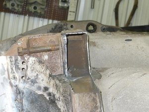

A couple pics to give you an idea..
P.S the bushings in the rear frame are flush and fit in the tubes supplied in the kit.

As you can see, I've built the front spring boxes but have not drilled the holes. If I move the holes back 1" in the front spring hangers and install the spring tubes at the rear in the existing hole in the frame, will this cause the shackle to bottom out on the frame? If I drill holes at the rear that match up with the existing rear pearch holes, I don't think there is sufficient clearence for the shackles to clear the rear supports. I could have new springs built that are approximately 2" shorter than stock and solve all problems. That's not going to be cheap!!! th_P1010531.jpg
From other pics I have seen from other peoples builds. The existing hole just barely works. If you are putting that much work into the car and you have the rotissery to get a good angle, I would just weld up the existing and make a new sleeved hole back further. just my opinion though.
You need to do to the back what you do to the front. If you move the front 1" then you need to move the back 1" in the same direction. If you don't then you will be limiting the travel the spring has and it will make for a ruff ride.
I think if the rear shackel location is moved back 1'' it will contact the frame support for the origional mounting bracket.

Burntorange70, I took part of your suggestion on cutting the rear frame out. I didn't like the way the sliders were looking and considering the fact that I have to drive on gravel roads to and from my house, I thought they might not be the best overall solution. After measuring the angle of the rear shackles(loaded and unloaded) I found that if I notched the rear brace 2 1/4" this would give ample room for stock spring mounting or 1" to the rear mounting. By drilling the hole in the same place as the original rear hanger I gained the 1" I was needing. The existing hole in the frame that most suggested I use, is 1" closer to the front. I didn't want to remove the complete rear frame since that portion helps support the outer bolts for the rear bumper. And also the rotisserie is bolted to it!!!! Thanks for the idea.
