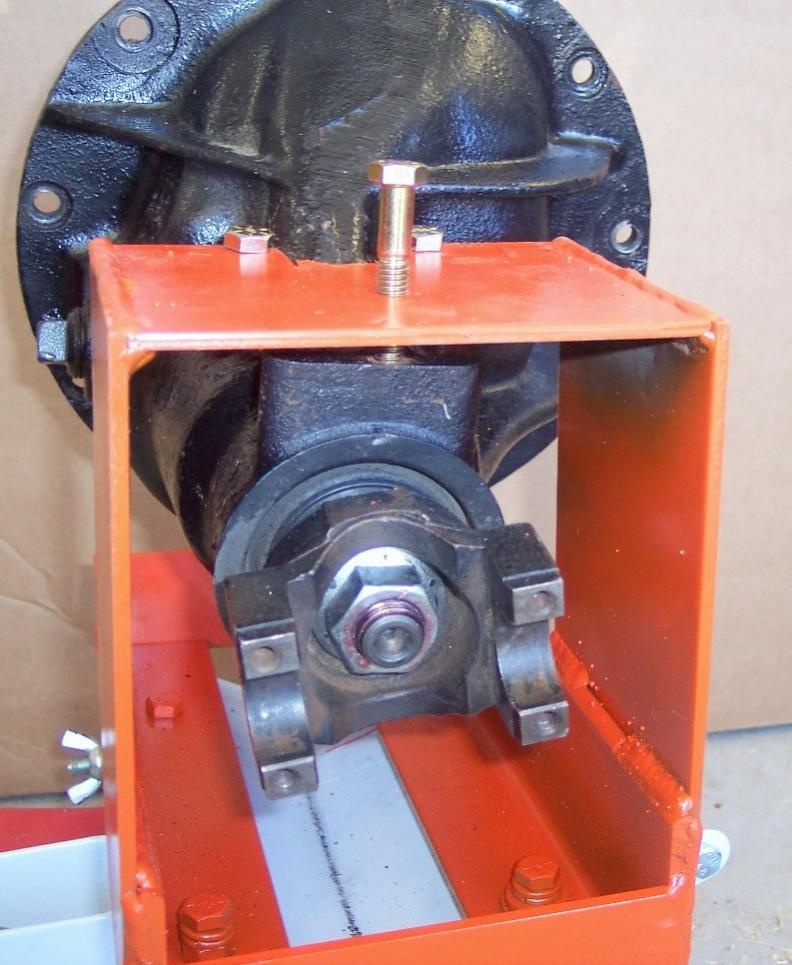

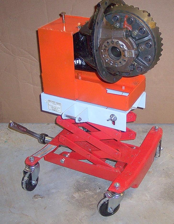

Here's something you could build (I'm an idiot, and I built this one, so I know you could do it with your eyes closed).
It just takes a Harbor Freight transmission jack and some 1/8"-thick steel plate and a couple of bolts (and a welder.)
I had a friend weld it up for me.
Now, the heaviest thing I have to lift, changing third members, is a half-inch drive ratchet handle.... to raise the chunk up to the housing. Fore and aft angle-"registration" is taken care of by that single bolt in the front. You can vary the angle of the axle-housing, side-to-side, to get the bolts to line up.
Cheap and easy to build...

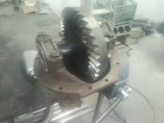

ok so today went thru hell trying to get some 8.75 gaskets... parts stores dont list them in the computer under normal cars so it was fun to say the least...

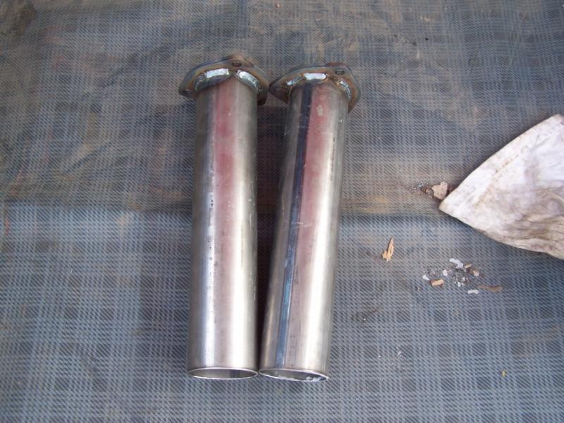

i did get the collector extensions welded up and painted... i made them 12" based off of the .org pic... i will test length and dia on another night...
I guess silicone sealer works, in lieu of a gasket for this application. I've never tried it, but preople tell me it works fine....
Been sealing diffs for years with just RTV. never had an issue, everything from 8.75's to 9's to 9.25's to 9.75's not so much as a single drip.
I drove a '71 LTD 429CID with a spool in a 9 inch with stock axles not an issue other than eating tires like there was no tomorrow. David

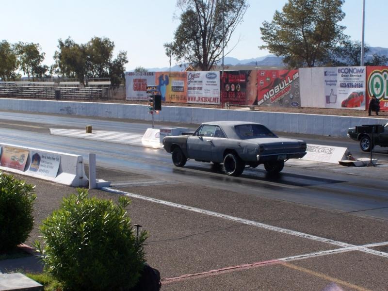

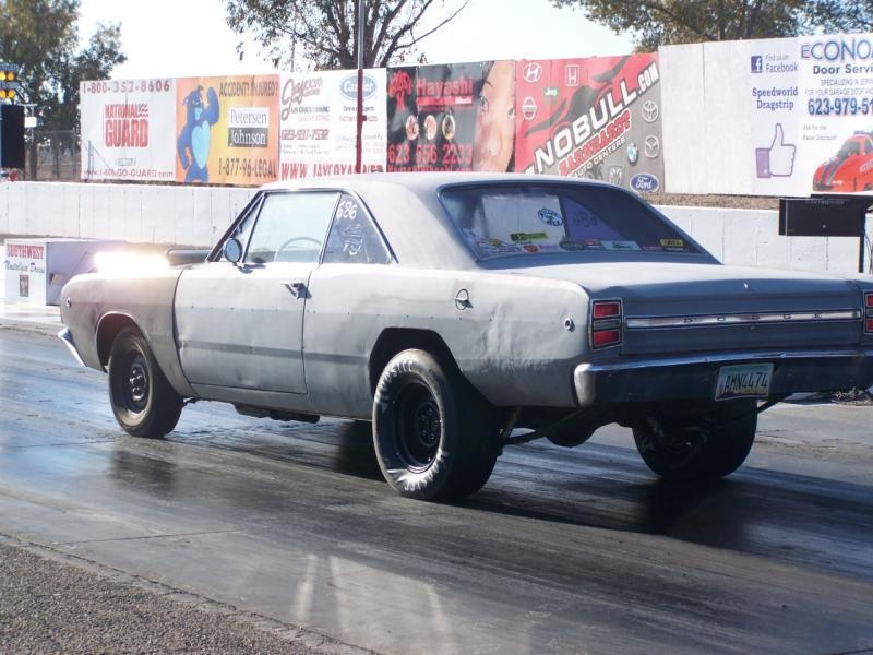

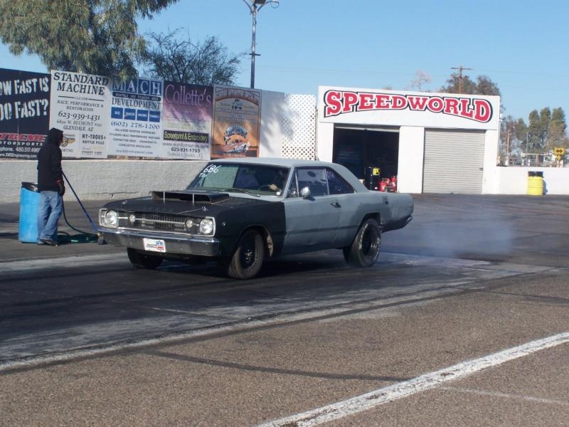

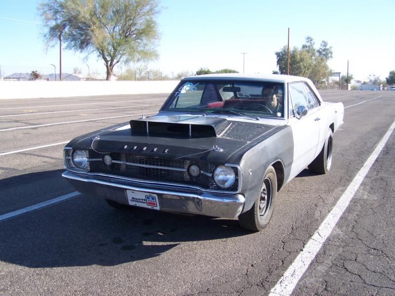

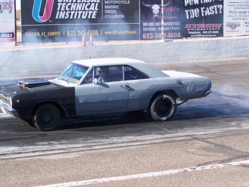

well it was a good and bad day! i got the 4.88's in and it drove great! a little noisy but no big...
the car was shooting ducks from the top of every gear (5400-)
so second pass i only reved to 5400 and upped the jets 2 and made it worse so i think my little carter pump is getting the heave ho for a holley blue and regulator...
but here are the times and pics...
1.91 60
5.73 330'
8.98 1/8 ET
75.5 1/8 MPH
14.25 1/4 ET
91.8 1/4 MPH
P.S. check out the front end on the last two pics...
Great job!
Personally.I thought that your 4.88's were going to kill your mph and I thought your 60 ft would be better...
You proved me wrong on the mph.You are chipping away at your time consistently.
Great job and can not wait for your next improvement,
Time to change your signature with your new time!!!
13's are around the corner !!!
1.91 60
5.73 330'
8.98 1/8 ET
75.5 1/8 MPH
14.25 1/4 ET
91.8 1/4 MPH
I think that's a really good 60-foot time for your mph and e.t., and yes, I realize that with the engine not running up to its potential, (due to "shooting ducks")your quarter mile times (and most incremental times) weren't as fast as they should and, will be.
Your efforts are paying off and are getting the chassis sorted out to the point that when and if you ever put some significantly greater horsepower in that car, it's gonna really fly...
I think you know what I mean....
:wack:
Thanks Bill for that labour saver! I will for sure end up making something like that. I really like the fact one can adjust the angle of the whole machined face when you get it close to the axle. That bolt up top is a great touch!
