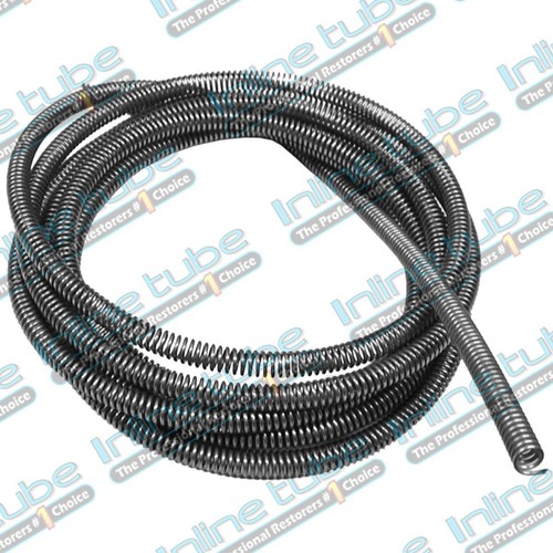

Naw, it's a michigan car and rust is too much of an issue and the original lines have that spring wire cover over them so i can't really inspect them well enough, not worth taking a chance of an accident by being lazy :)
You can buy the spring, called Gravel guard you want it back on it.
Thanks, i was actually wondering about that, though of buying a pre-bent brake line kit but i didn't see any with that covering, not that i need it.. i probably won't put 100 miles a year on the car.. just building something out of boredom
That spring wire is called 'amour' and can be bought. Well worth it for peace of mind when replacing a line that has it. You all saw what some rock or road debris did to my oil pan. Damn near put a hole through it!
