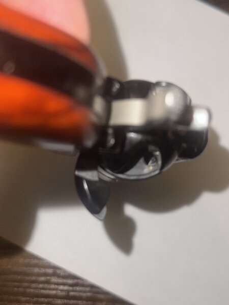

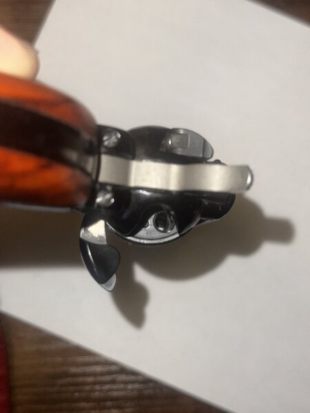

I think I need to send this revolver off to a gun smith. It’s a simple single stage revolver that appears to be stripped internally
Not sure what you mean. It looks like a single action with side gate loading like Single Action Army etc. There is nothing 'simple' about a revolver mechanism that I've seen so far. Insides are always a bit of clockwork. On the other hand (pun not intended) if it locks up on 2 of the six, then it would seem to be a matter of adjusting the ratchets.
Check the lock up position with a range rod to make sure the chambers align with the barrel and forcing cone. Or you might be able to eyeball it if the firing pin is hammer mounted.
if those are good then it the hand to cylinder relationship.
Remove the cylinder and look at the ratchets, or whatever Heritage calls 'em. S&W calls them ratchets IIRC. Traditionally they are hand fitted. Now with modern manufacturing somewhat less so - maybe.
Try contacting the manufacturer?
Yeah I sent them an email and this video and pics. 3/6 line up fine, the other 3 I have to lock the cylinder in place. You can also see damage on the cylinder on those 3 slots. Where the firing pin hit the cylinder.
