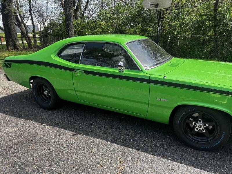

How serious on the handling do you want to get? Looks sorta setup for drags now?
Basic significant upgrade that you will certainly feel without taking a 2nd mortgage on your house.

Okay thanks for the advice. I appreciate it. It’s just a street car. Runs great. Just wanting it to handle better
