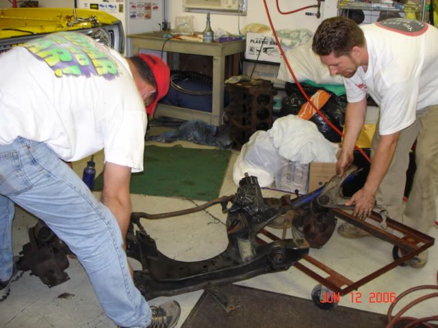

just slide an engine hoist in from the side... i pulled the stock k-frame then installed the alter-k like this.. no issues. made things easy..
Hey everyone, sure appreciate the tips and pictures - great help!
