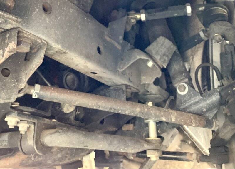

Q1-
Yes, with the '73+ K frame and the QA1 LCA's you want the Hellwig 55905. That's exactly the combination I run. This isn't the greatest picture but it shows the LCA and sway bar pretty well. I shortened the end links a bit when I installed the QA1 LCA's, I had previously been running 73+ LCA's with stock sway bar tabs and that was the only change going to the QA1's.

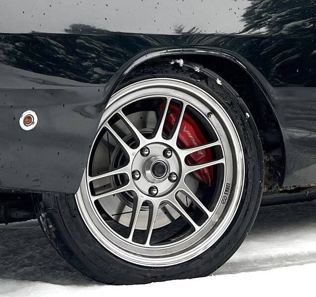

I've also been running the DoctorDiff Stage IV kit, although I didn't spring for the 2 piece rotors. It's a really nice set up with the 11.7" rear disks and a 15/16" master cylinder.
img_5981-jpeg.1716309247
