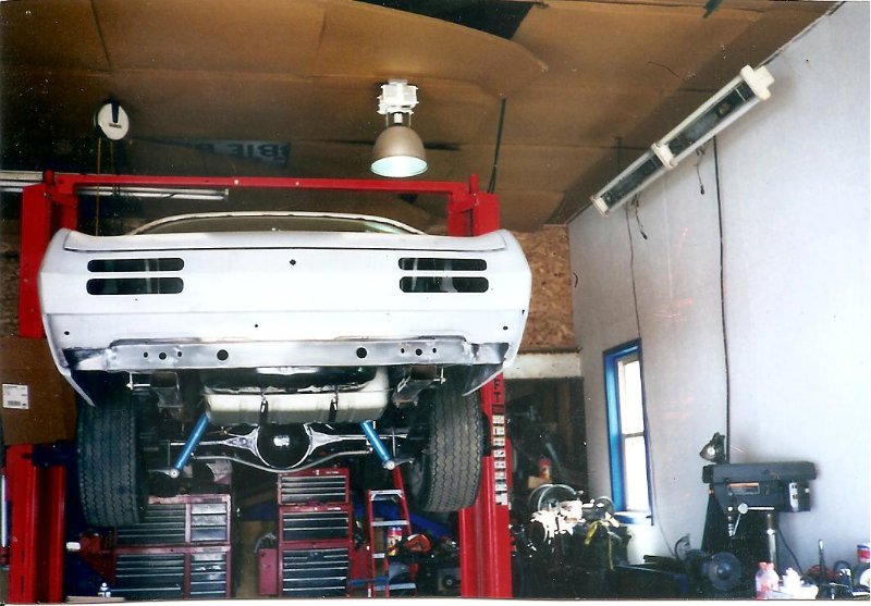

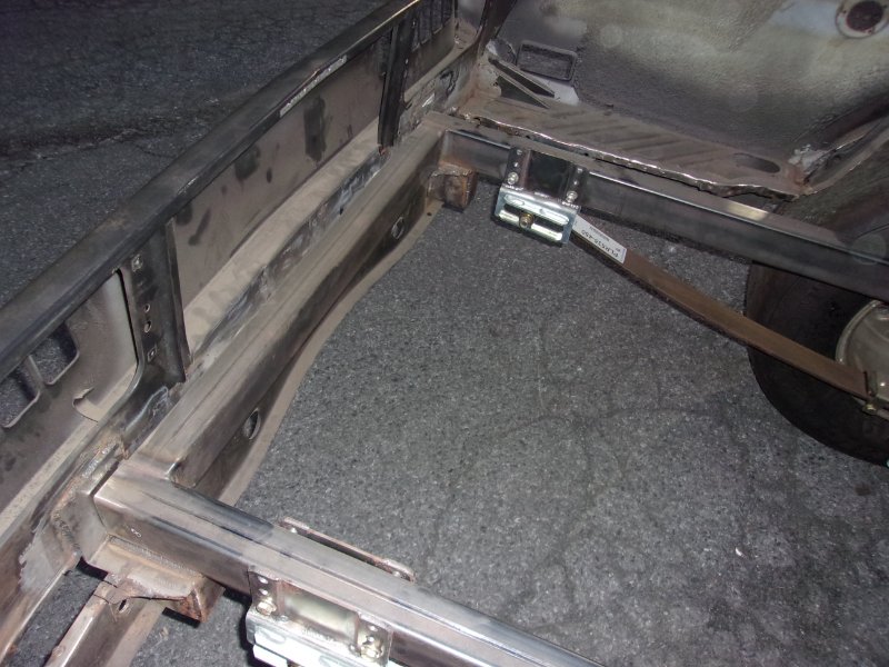

We don't limit our builds to sway bars. We put complete chassis together. This was a rust free 4 speed car that my small block would have dish ragged.
My son Just built a 6.4 Hemi 66 coronet 1150 to the tire . If you all wouldn't be so vindictive on this site he would probably post on here , He is a member. He thinks many of you treat others like *** holes. No real discussions just just condescending comments to lift yourself on pedestals looking down on what you don't have or know.
I myself love it, and like the way you contradict yourselves many times. Do I know it all ? No I don't. But a hell of a lot more then you critics. Members on this site buy a lot of parts from me and come to our shops. Many of them think you are fools. Including some of the staff.
He could post a picture book on here and you would all be amazed what we do in our combined shops. Only to be criticized by the left coast. Steve said its not worth his time of day.

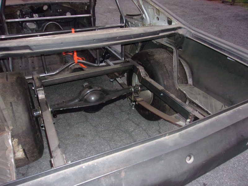

So let's see. We've got US Cartool subframe connectors, a back half with sliders, and a cage. That's it. I'm supposed to be impressed? Hell I've installed USCT subframe connects, and I run sliders too. Haven't done a back half, but I have replaced frame rails. Oh, and I did all the welding for the cage/chassis on an FSAE car back in college. So, what's your point? Nothing in those pictures I can’t do myself, and I do this for fun.
You STILL haven't answered the question about torsion bars, and you've posted what is clearly a drag car.
You've never built or driven anything Mopar to handle. Not for autoX, not for road racing, not even something that would handle well on the street.

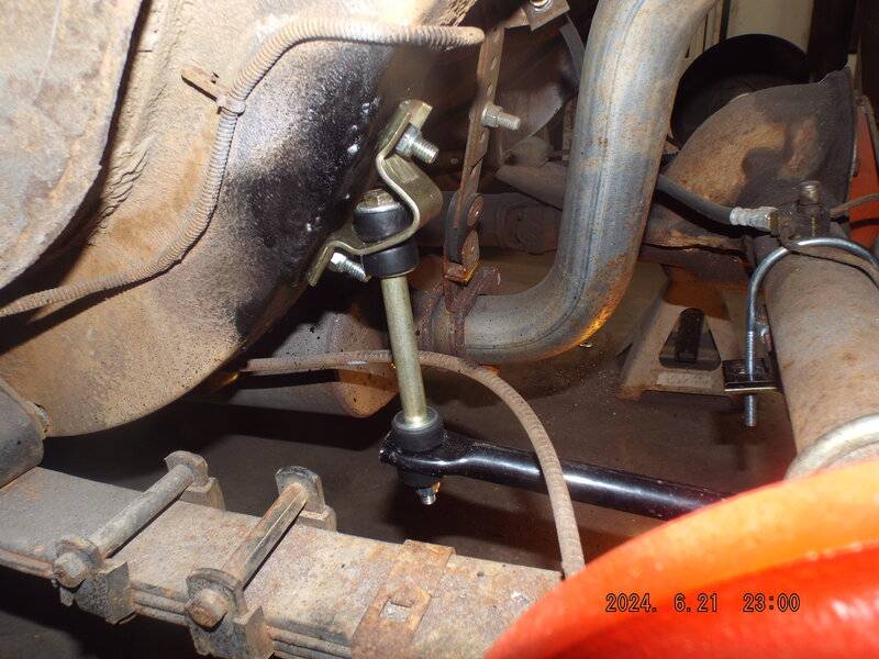

I run front and rear sway bars on my Duster, my rear bar is actually a larger, 7/8” e-body Hellwig.
The important thing is that you’re adding the sway bar to balance the car. The whole deal about A-bodies not needing them is complete garbage, but it does depend on how the car is set up with the rest of the suspension and tires.

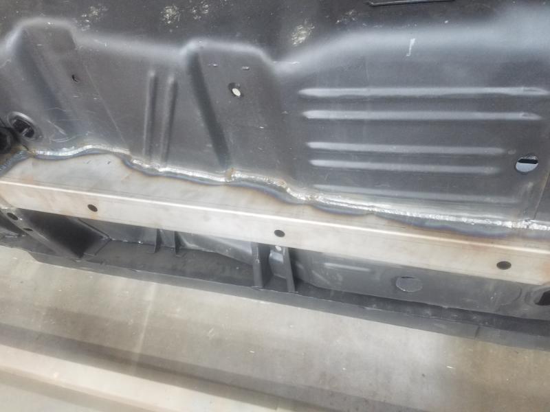

I was happy with the hardware for the rear. The only thing I changed was to weld two 1/4" steel plates on the frame rails where the end links attach. I had read somewhere on here that the it was possible for the U bolts to pull through the frame rail. Not this white boy. Maybe you can see the plate the end link bracket is mounted to. I sprayed it all with undercoating.
Any mount thru the frame rails needs a piece of tubing( ID bolt sized)clear thru the frame rail & welded to frame rail. Heavier plate only might cause lighter rail sheet metal to crack next to weld. Doing both(with lighter plate) probably best to spread the load.
