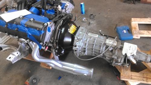

Once I installed the spacer it brought the bleeder to where the flange is. I grind' a path for it in the flange. I'll take a picture and post it. Other than that I think I'm gonna be putting everything in the car....
Riddler
You know what, my bell has a notch in it already. I do remember on the BB that the rubber sleeve on the bleeder was tight against as you say.
