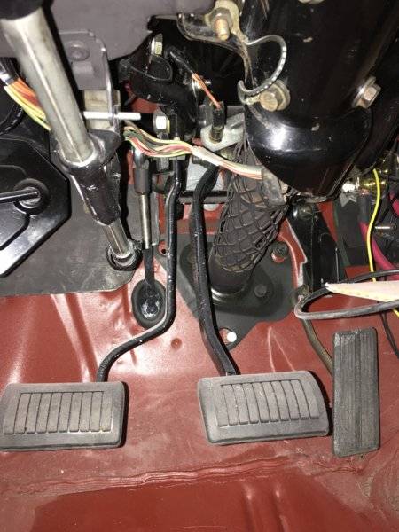

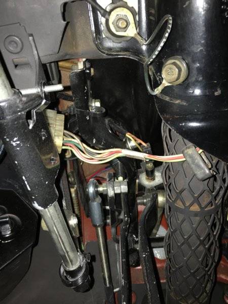

This is a clutch tamer on my 66 A body. Put it in with a Ram powergrip hd clutch to finish out the season last fall, after my soft-loc finley wore out after 7 years. Soft-loc is going back in and this is going in my 2012 Challenger R/T 6 spd.
I didnt realize the early A pedals were so different from the rest ...
I think there's a few different versions of mounting possibilities. But I never thought that it came with an offset pedal Mount as well which could factor in well.
I ordered the offset separately.
j par I still had the 2 step from the soft-loc hooked up with the clutch tamer. It's at the top of the pedal set up with a long arm micro switch so the tab for the overcenter spring engages the arm on the micro switch, bent the arm so the 2 step comes off just before the clutch hits. Set up with 2 relays and activates off the line lock button.
I measured how far over from the pedal I needed it so I had a straight shot to the dash bracket between the column and hand brake bracket, and gave that measurement to Grant and he sent me the clutch pedal bracket with the right offset to work.
This is a clutch tamer on my 66 A body. Put it in with a Ram powergrip hd clutch to finish out the season last fall, after my soft-loc finley wore out after 7 years. Soft-loc is going back in and this is going in my 2012 Challenger R/T 6 spd.View attachment 1715386839 View attachment 1715386840
