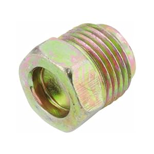

Go down to the parts store. Get what is called a 3/16 inverted flare union and a 3/16 inverted flare male plug. Alternatively, get a 3/16 inverted flare "half union" which is inverted flare on one end and pipe thread on the other. Then get a pip plug to fit the pipe end. Any good parts store with a "brass cabinet" will have them
