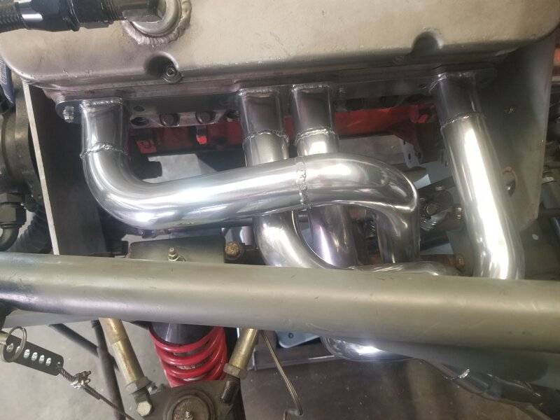

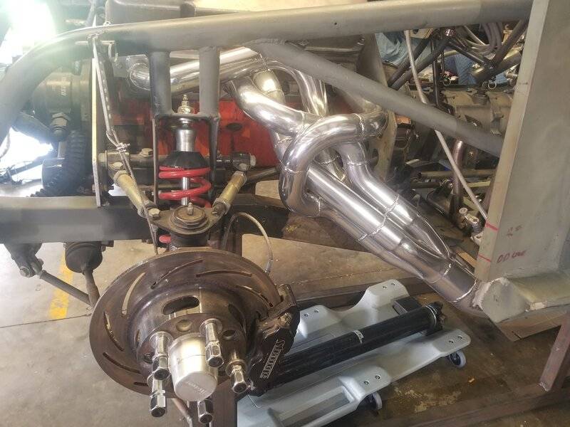

OK, time for an update, headers are done and ceramic coated. Please ignore my crappy welding.

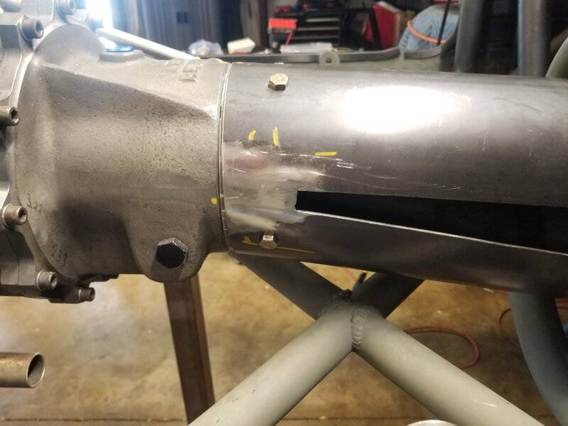

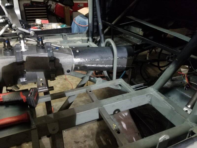

Had to spit the pipe to fit over the trans back plate and add weld in some fillers.
Instead of making fillers and welding them in the opening, my buddy, who owns Real Deal Steel suggested we use their industrial spot welder and make it look old school/ unique. I built some fillers and spot weld ed them in.

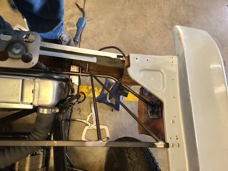

Next was the belly pan and janky drop down to clear the clutch linkage.
Got the wheelie bars welded up and had to make a upper mount for them. Used the ladder bar bracket and made an adjustable upper mount so I can go up or down 3/4" if needed.

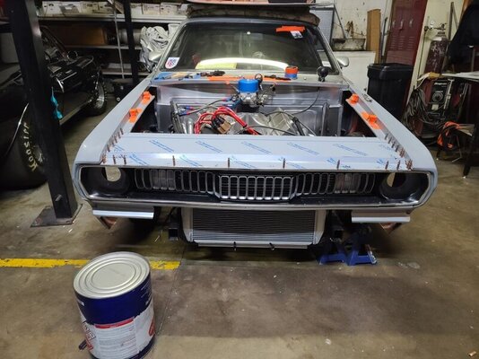

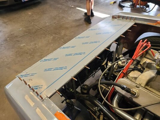

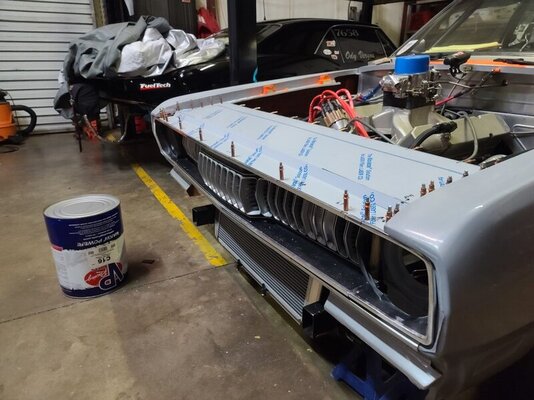

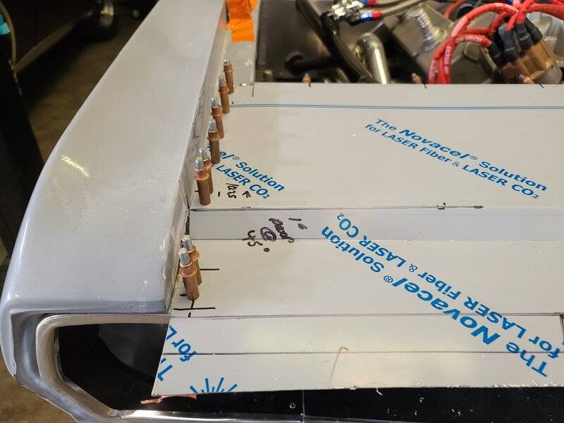

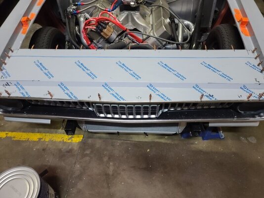

Hood scoop and bodywork, cut the scoop down 2.5" in the back so it is more level.
Front end and hood have been primed and blocked are ready for paint, should have it painted this week. After that, just minor fitment on the front end and headlight/park lamp wiring is all that is left. Off the front end shop for alignment Monday and might even make it to the track next week :)
