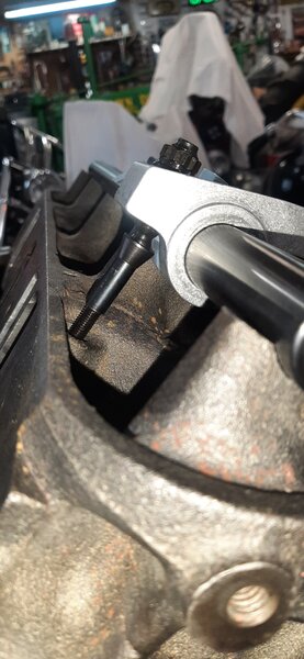

I did do research. I read everything on Hughes website about their gift from God rockers. It didn't say I needed to hog out my pushrod holes 1/8 inch. If it did, I would have done that first or got 1.5s. Once again you say I'm trashing him because I don't know what I'm doing or I'm a Karen. It's his attitude, why is it so hard for you to comprehend the guy didn't even want to talk to me about it. I'm a reasonable person.

So here's the Mancini 1.6 rockers I got. They are made by Harland Sharp.
Tell me why Hughes can't make theirs line up with the pushrods better. But according to Newbomb, I should've known how poorly they were going to fit in advance. And it's not Dave's fault having to answer questions about the $1072.00 rocker arms he sells. That poor guy Dave, he has it so rough having to help paying customers. If having to answer questions gets him that emotional, he should stay off the phone.

See, those adjusted are so far in... that you can't even see a thread, and that would change the position dramatically...I think they would have fit and Dave screwed up by just being a Dave...

I run 1.6 rockers and they didn’t fit either. Why? Because the heads were designed for 1.5 rockers. That means the pushrod tunnels and everything else is wrong for anything but a 1.5 rocker.
You not only need to clearance the tunnels for 1.6 rockers you need to correct the geometry.

I don't know. Is the checking pushrod adjuster sleeve resting on the tunnel wall?

If he didn’t correct the geometry or at least measure for it and see if it needs to be corrected, he’ll be no different than the thousands of other Chrysler guts out driving around with junk **** geometry.

A simple “pushrod clearancing may be required” would have made all the difference.
