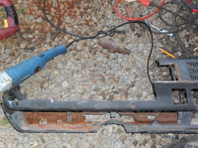

so, now it was time to move onto the dashframe itself. mine was in good shape, but rotted completly apart on driver side up near the windshield gasket
si i bought one from member. well, it got here, and i just took it out of the box, it looked like it was ran over by a truck. so i tried to mount it in the 340 dart i have, and it was a no go. the metal was too kinked and flexed to even come close. and i do not want to put the rallye dash in a frame that my crack it due to being tweaked so serverly.
so i decided to cut up a perfect non rallye dash. i did not want to use just the lip, as then alot of tedious bodywork would have to be done to make it look right.
so i decided to make all the cuts go under where the dashpad itself goes. the only line that has to be welded right, without doing any bodywork is where it goes from the driver side vent, to the the front of car at the winsheild gasket.(is only like an inch long)
so here is it cut out, and then scribed the new piece. cut is, and then tacked it in place. kids are hungry, so i must stop.....for nao. tune in at 10:00 pm for all welding to be done.lol
